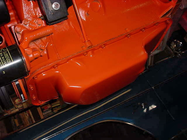

A real max wedge has an oil pan unique to that motor and was not installed on anything else. All max wedge blocks have AAQA embossed on the front of the block on the drivers side.
And here it is .

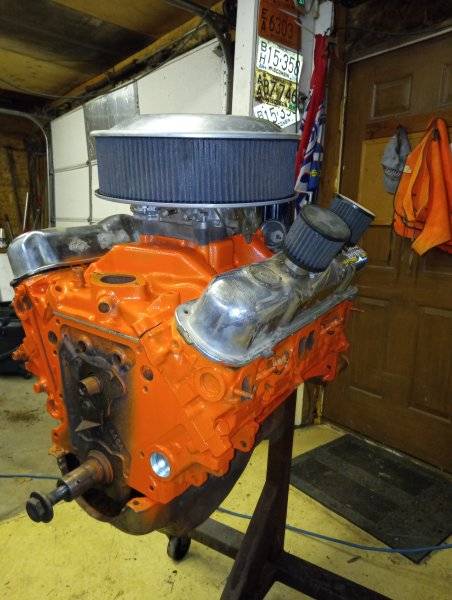

Are you sure they are Stage VI aluminum heads? Those are raised port heads and a factory cross ram wouldn't fit with those heads on a 413 block. It would fit those heads if they were on a 383 block. Do you have pictures of the engine?
