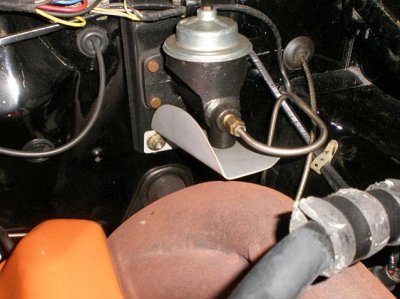

The dual cylinder will work but there wont be much clearance with the manifold.If you plan on driving you better make yourself some kind of a heat shield,that manifold will boil the brake fluid in the master cylinder.
