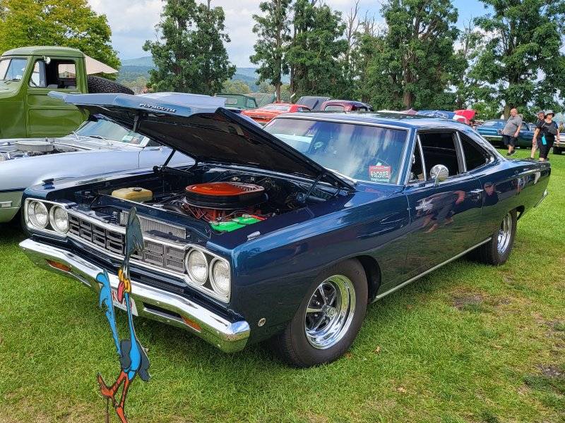

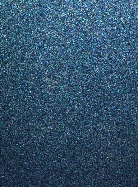

Uncovered the never-seen-sun paint on the package tray. This compared to the new paint. 57 years old first.
