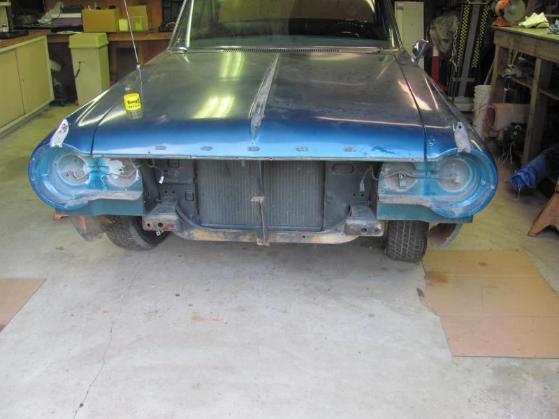

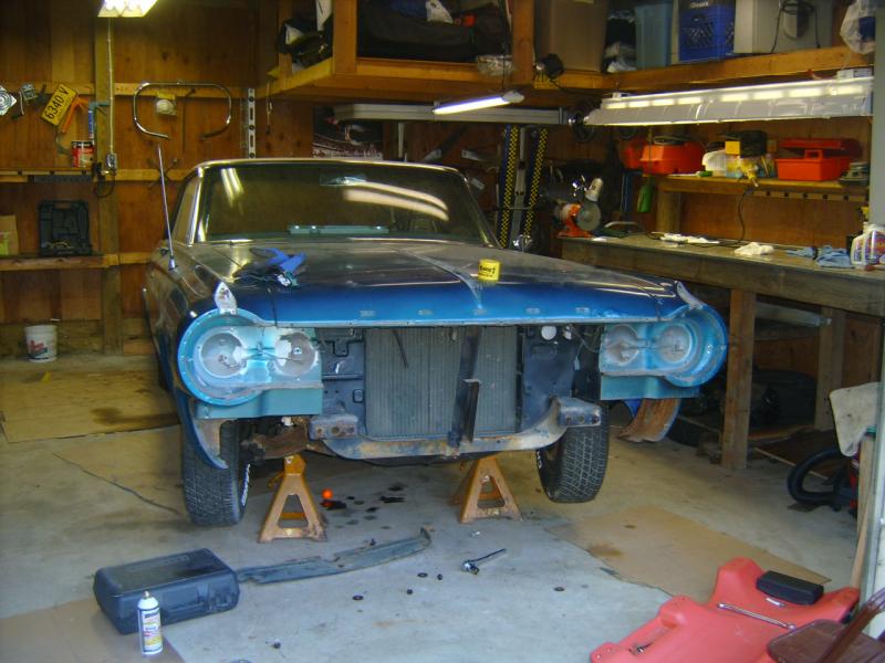

I will add some photos soon of my project 64 Polara. Right now she doesn't look like much. I just welded new floors into the car. The windshield leaked for decades before I got the car from Florida. I just replaced the drivers cowl and had to rebuild the passengers cowl myself since they don't re-pop these for us older Mopar car guys. It would have been easier to get a late 60's car but I love the 64 Dodge and Plymouth cars. I raced a 64 Fury when I was a kid and since I could not find one of those I found my 64 Polara and started on that.

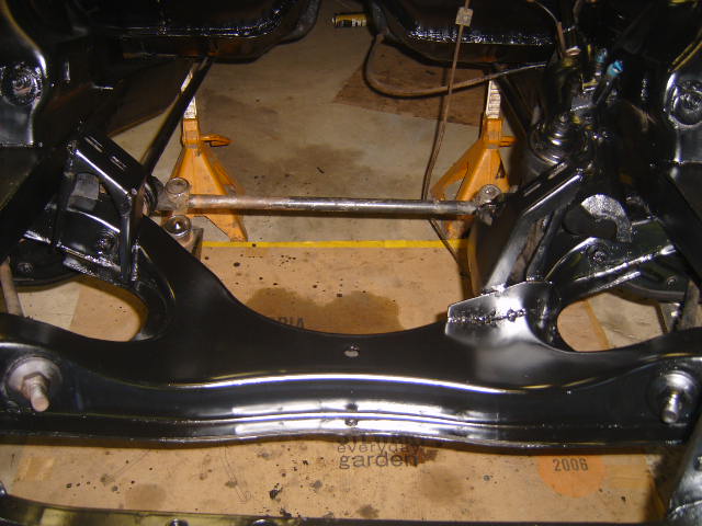

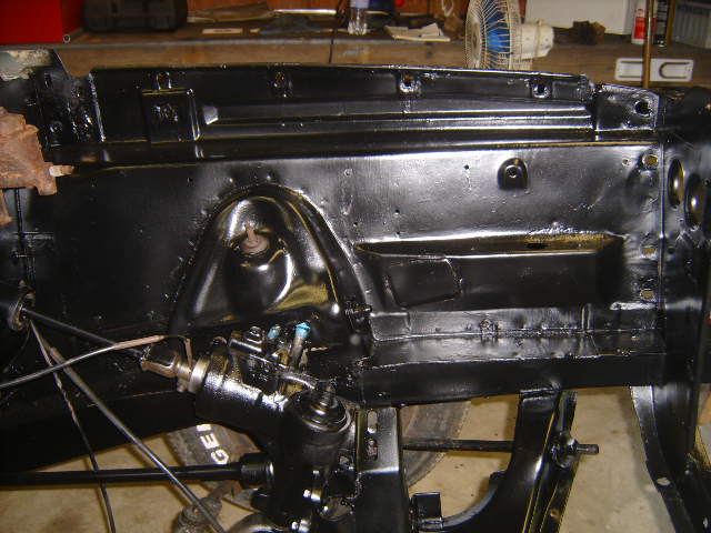

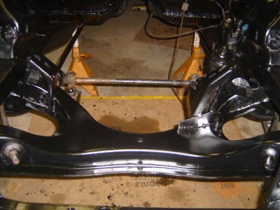

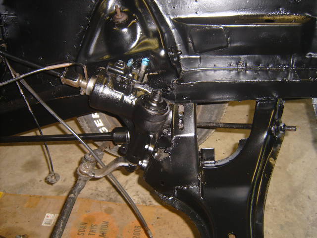

Just put new upper control arms on today. Next week I will put the new torsion bars in and all the new front end parts.

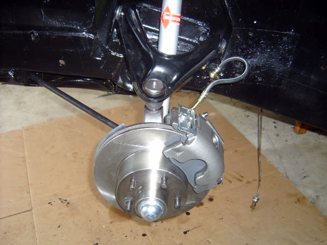

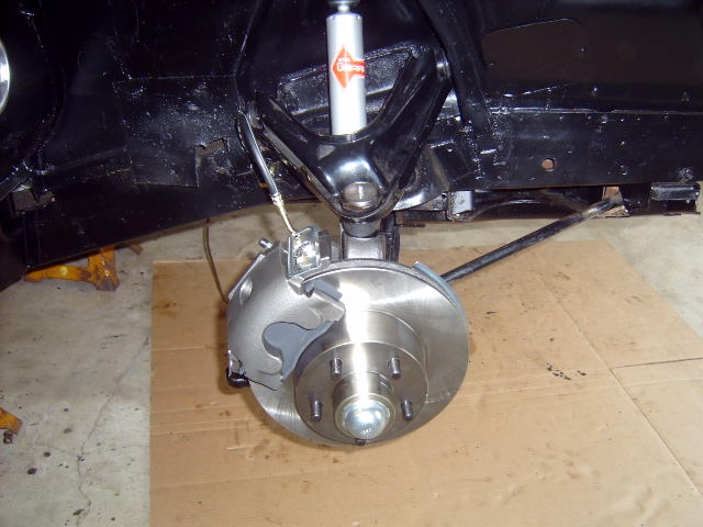

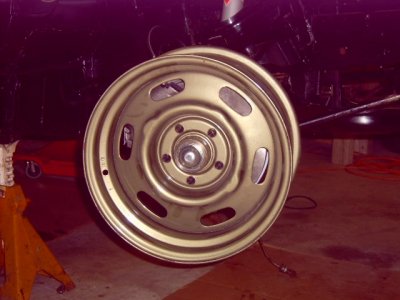

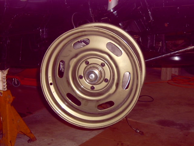

I got my front suspension mostly done in the last two days. New everything...including disc brake conversion and new torsion bars. Took the 0.881" bars off and went with 1.03" bars. New tie rods, new upper control arms, new idler, and a new pitman arm. Should steer and ride nice and safely at >120mph. I bought a beautiful set of "like new" 15" cop wheel and dog dish caps at a swap meet for a real good price. These will be my street wheels and another set for the track.
hi and welcome to the site :worthless_thread:come on show us your pictures they all want to see your car **** :headbang:
maybe tomorrow I will post some pics. Satiate the picture requests.:thumbsup:

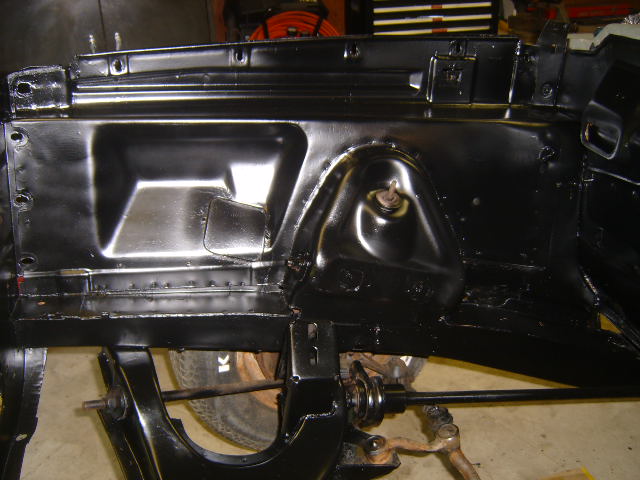

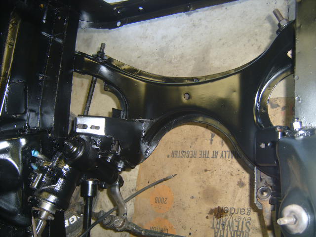

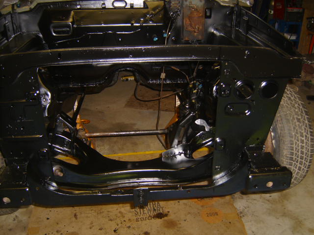

well...i do them when i can so...here are a few to mull over. underhood done  (2).JPGunderhood done  (3).JPGunderhood done  (4).JPGunderhood done  (5).JPGunderhood done  (6).JPGunderhood done  (7).JPG
so...lots of "car ****" not in any order...lots of work going on
so how did I do AMX364?
thanks for the compliment. Its a labor of love of course. Lots more to do but I have the time now to get on it. I have a 426 wedge and steel crank I plan to start on this fall. it seems buying pistons for this engine will be something of an issue. Not many available for this 4.25 bore. Push button madness is the plan.
Sounds like the power plant will be as cool as the way she looks!, I wont talk about fall though, winter follows and im trying to forget the cold and snow lol.. trouble is, it doesn't seem to want to warm up here much yet :) Good luck, it really is looking great!
