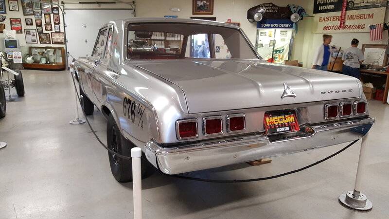

Question guys. Picked up 64 330 sedan parts car. Has three tail lights per side instead of two. Thought 330's all were two per side. Was three per an option for that model or was it like alot of mopars where you could order just about anything you wanted and they would oblige. All lights are red. No back up lights
Maybe somebody added them like they used to do on 2nd gen Corvettes?
Dick Landy would do this because he liked the looks of three lights. Don't remember if he ordered them that way or bought extra ones and installed them himself. Is your center one a backup light or red?
Usa made or canadian made it makes a difference.
Bearman is correct. A member from Canada started a post here a week to 10 days ago about a 64 Dodge that he had recently purchased. To us in the USA the trim on the car said Dodge 330 but it had the 3 per side taillights like the Polara.
The Canadian Polara’s were built slightly differently than their US counterparts.
Does the dash board have round gauges or the slide type. The round gauges were on the Canadian version. Slide type usa made.
