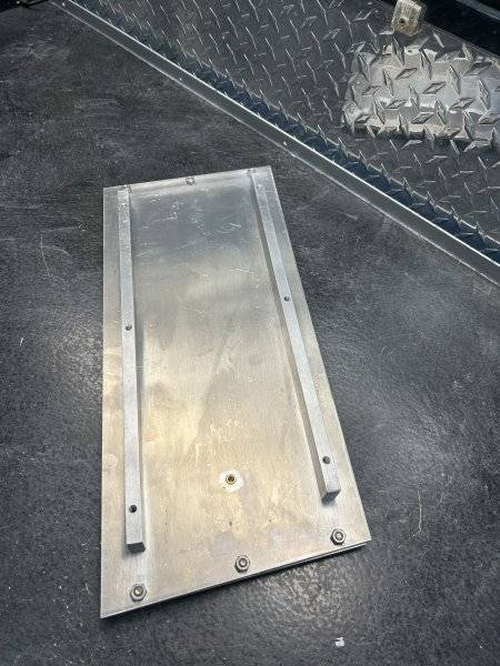

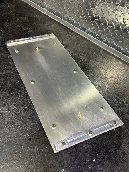

Looking good Bob, as always. Hoping you have better luck than I did with the Edelbrock valley pan. After the second one cracked I made my own out of 1/4” aluminum. Actually made 2 of them and the spare has now been reinforced. A couple of pics.
Amazing how much those valley plates implode when you put vacuum into the engine.

Hi Bob. Yes, the plate you see has no sides. However, my factory Edelbrock plates both did have the side bolts. Both of them cracked right along the sharp bend under the bolts about the centre. At that time I was running breathers and hoses exiting to under the car which got rid of crankcase pressure. I run a vacuum pump these days, which implodes the 1/4” valley plate, which is why I have reinforced it.
Glad that the plate you’re using is thicker, it may not crack like the edelbrock ones.
Just thinking, I still have my cracked plates, I used one as a template for my current bench made ones. The reason I noticed they were cracked was the oil laying on the plate under the carb. There was no obvious way for that area to get wet.
