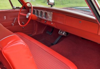

anyone know if the glove box door is smooth finish on a super stock car? My stock fury glove box door has very small vertical ribs similar to the gauge cluster. I noticed that most red superstock cars had a smooth looking glove box door painted the same color as the dash. Mine is silver right now, and I was planning on painting it red. I like the look of the smooth better. Where do I find one of these smooth glove box doors or did they not have them in a fury?

You need this glove box door(see photo), from a Savoy. A Belvedere has 2 holes in lower right corner for the "Belvedere" script. The carpet in the photo would be black in a Hemi car.
Thats exactly what i am talkin about. Thanks for the pic bt756. sweet lookin interior you got there:headbang:
