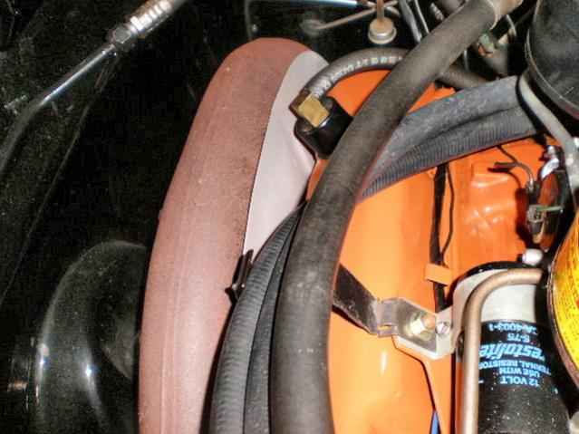

If building a Max Wedge,this is the correct PCV.

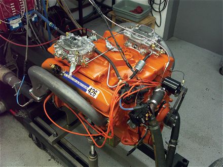

That looks like an inline dual quad intake!! The wiring harness runs along the pass side inner fender panel. Also the heater hoses run along the drivers side panel! I've never seen a PCV like that on a 63-64 MW! It might be correct for the 62s? But I don't think so.

i will back that up. The brass fitting is correct through 64. Started in use in 62. Also 64 valve covers do not have a raised ramp on the cover to the stacks. ie it's flat. 65's had that added. So it is sort of a one year only cover, and yes they could have been used up in early 65 production, and late 63's they did get started in use.
