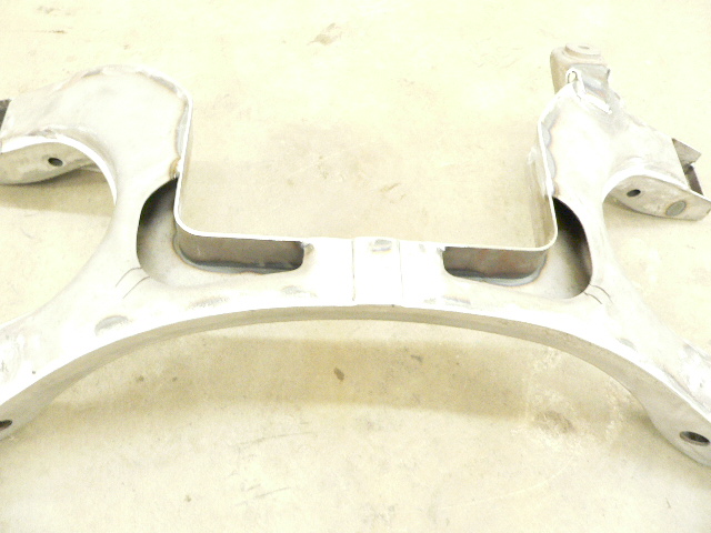

Is your K member tube or a stock one that's been cut? Do you have any pictures?

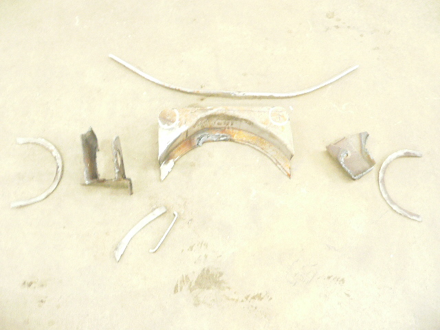

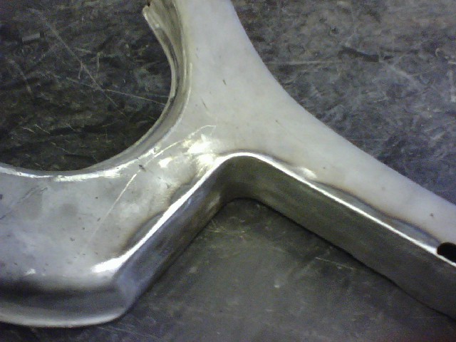

It's a cut stock part. I cut the spot welded flanges off, and rewelded the seam. Hole sawed the inner corners to give them a radius when the center was removed for pan clearance. Bent the center filler panel around a socket. Added tube support for the steering box. Fabbed filler patches for the Kidney shaped holes in the bottom. metal finished it and added the tie down loops.
dvw That K-Member looks great, nice job/fab work....
