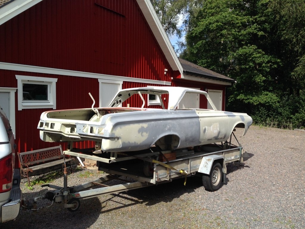

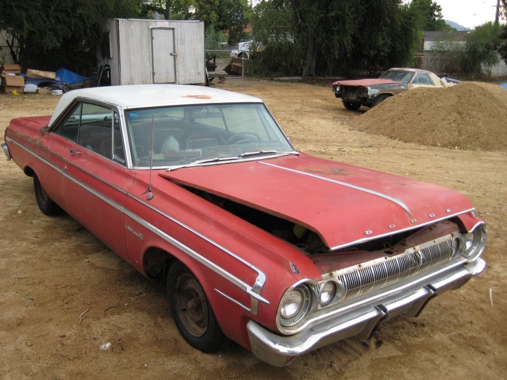

This is my project for the past 5 years, The car was an eBay ”barnfind” very ruff.
I liked the color thou and it had Air, PS, PB, electric window.
I should have stayed away from it, but that enter button is so easy to tap sometimes!
Anyway, now its beginning to be ready. Now it has a 440 stroked to 505, trans is a 727 from a
72 dodge van.

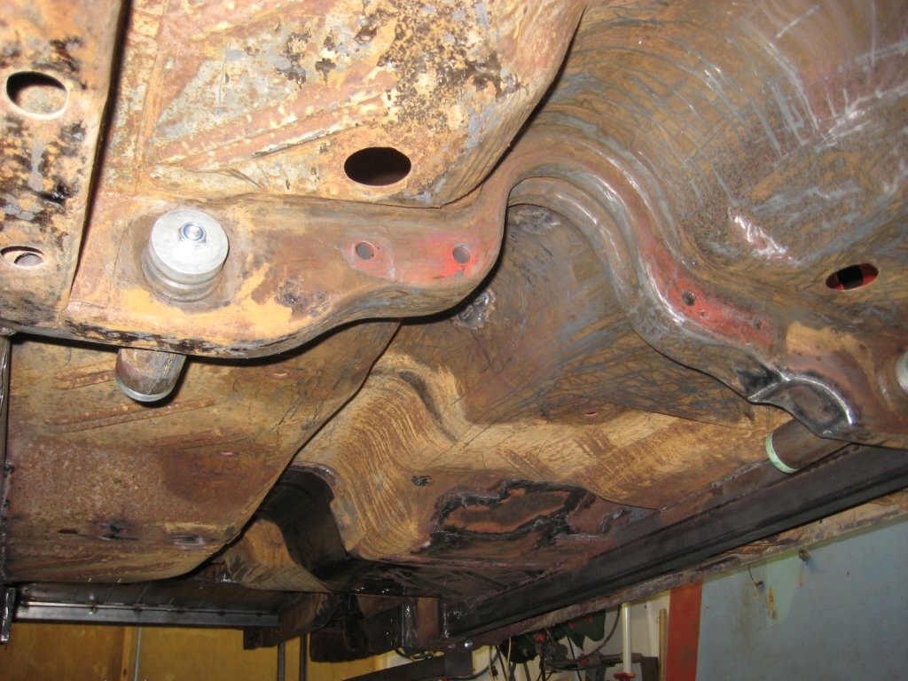

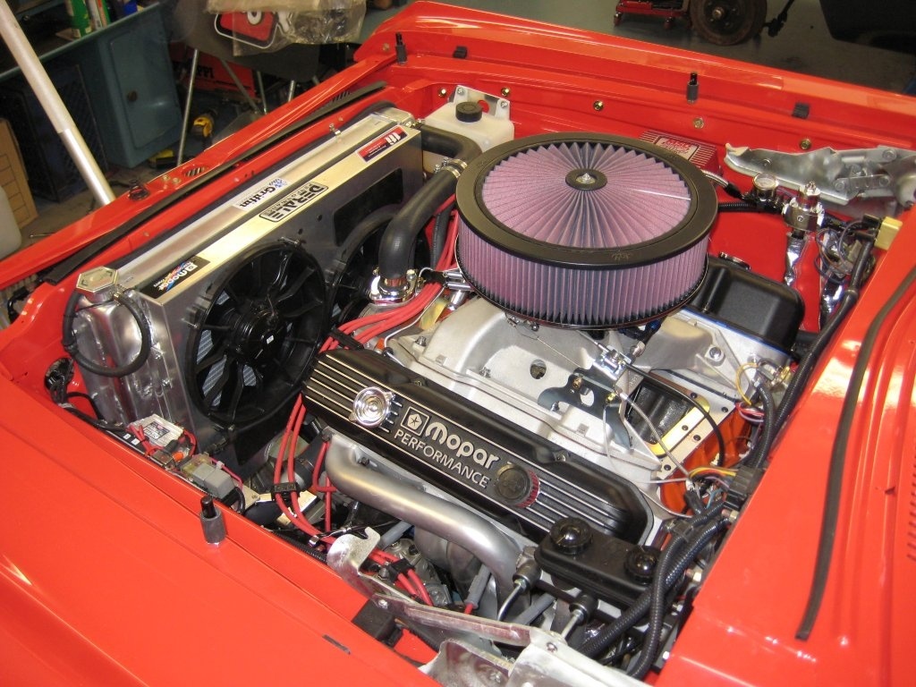

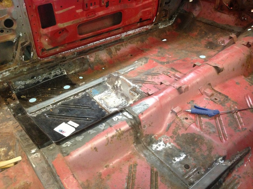

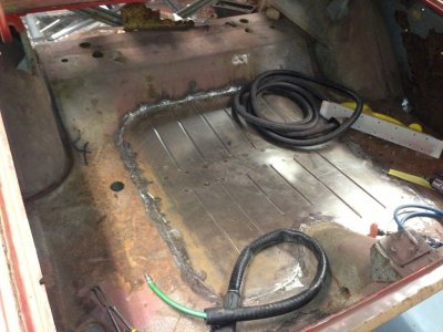

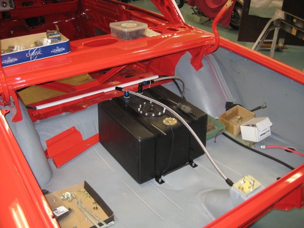

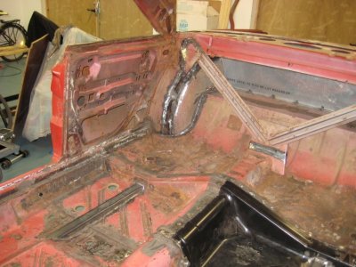

a couple of photos of the work on the chassi, I made a 2 inch wider wheel house, also seen is welded in frame connectors 40*80mm 3mm , the trunk floor as well as the gastank was completly rusted away so a fuel cell was an easy option for me.
I had a mokup engine installed and saw that there was no way my 2 inch TTI headers would fit, had to modify the frame a little, anybody has this experiance?
I have the straight connectors, i know tti sells a bent one. maybe that would worked for me.

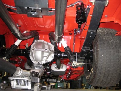

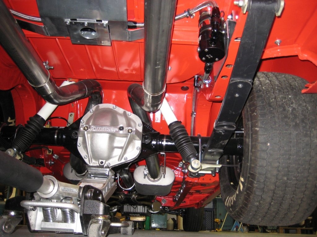

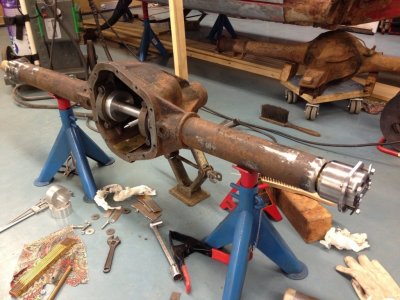

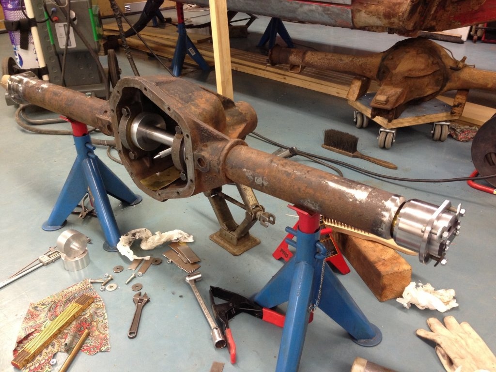

Here is my rear axle build, an 8 lug dana 60 from 80s dodge truck, I made it 52,5 wide f/f, it turned out to be just right, I didn’t have my wheels on hand when deciding width so there was a little
guess work involved.

My 2" TTI's fit with no hassle at all. Loads of clearance . I did have to put a dimple in one tube on the drivers side to clear a new pittman arm but that was it.

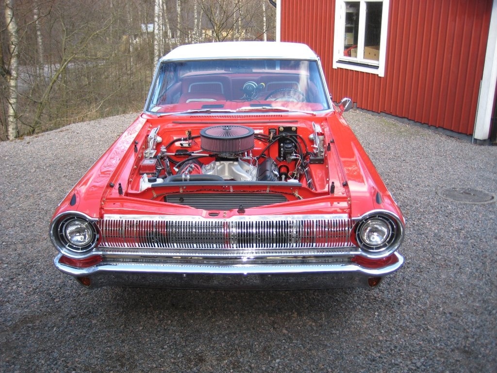

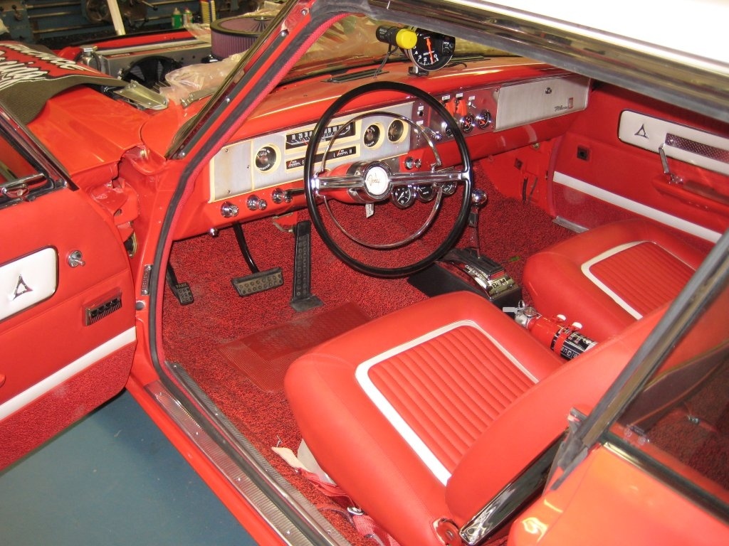

So now the car is soon ready for the first long tripp, I,v been out for a 1/2 mile trip so far.
just waiting for the hood to be finished from the paint shop, it,s a fiberglass hood and the painter told me that fiberglass is harder to paint than steel because it,s getting static electricity. what do i now!
no major problems so far besides a leaking rear main seal.
Then i have huge trouble tuning the engine but i guees this is the wrong
place for that.
