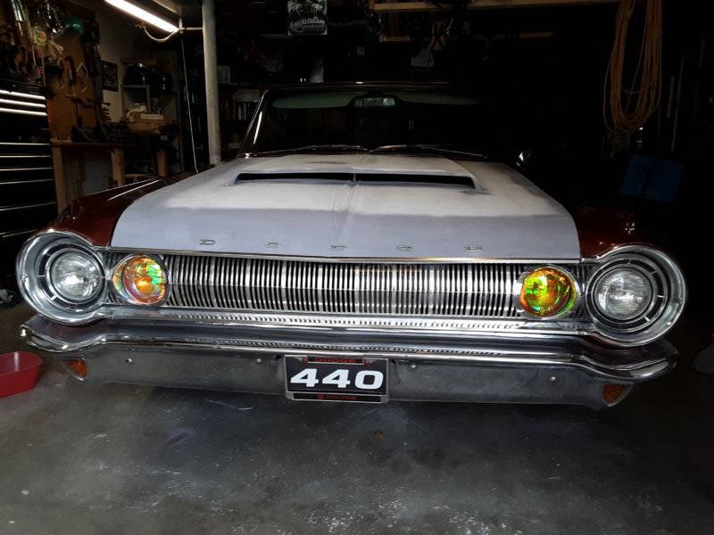

Always liked the Super Stock look in the 60's Mopars, so I decided to put a scoop on the car. At the suggestion of a few folks on here, rather than sticking one on my pristine genie steel hood, I bought one with a scoop installed. I was pretty disappointed with the fit.

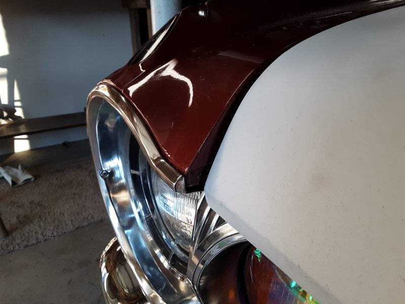

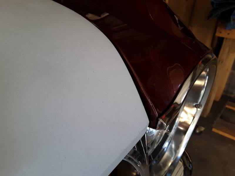

The front edge was "pushed in" nearly 3/4" on the passenger side and 1/2" on the drivers side, see the pics. I have done a lot of fiberglass boat work in the past so not too big a deal but between that and the waves along the edges it has been a safari. I'm getting close now, but it will never fit as nice as the original.
I wanted it to hinge so I reinforced the underside to accept the hinge brackets.

If you can take the car to the hood and check how well it fits first you may be ok with a whole hood. The one I got was 250 miles away so I was just going on faith that it would be a close fit. It wasn't. You are right about what to do with the original hood. I thought I might sell it to recoup some money. Now I don't really know if I'll like the 'glass hood well enough to stay with it. When all is said and done I'll have nearly $900 in it.

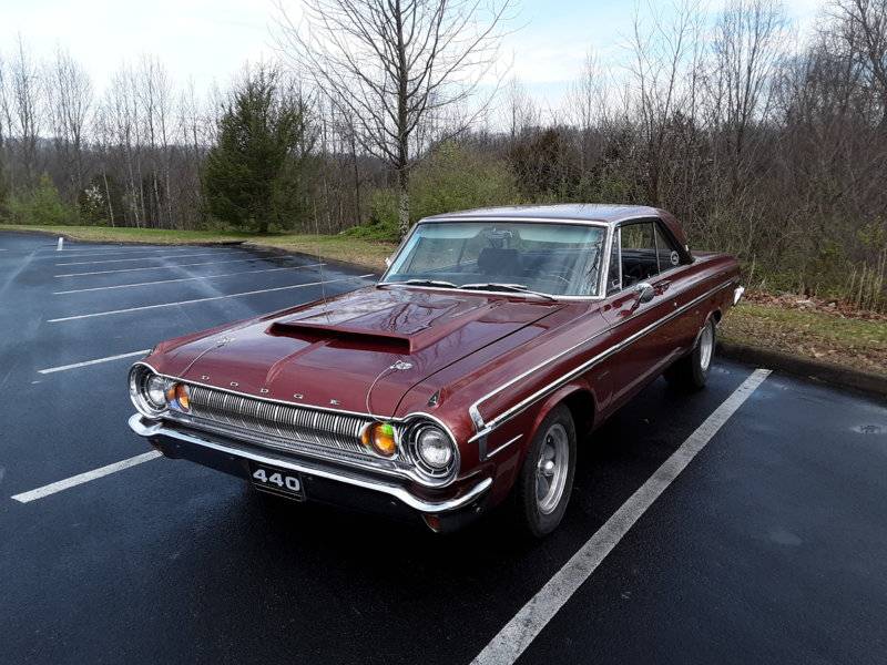

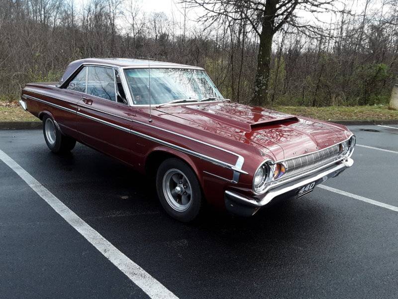

Well here's the "rest of the story".
I have completed this little project and like all of my work it don't look too bad if ya don't look too close.
The paint match is a little off, the fiberglass is a little wavy and the hood is a half inch too short ( at the windshield).
I finally had to glass in 1" aluminum angle but I made the gate springs from Lowes work so no prop rods.
This was a "race" hood from Sled City. It left a lot to be desired but like Dudley Do Right, I knew the job was dangerous when I took it.
