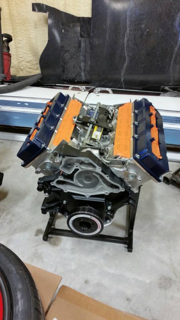

The motor is here. The chassis shop is going to go ahead and put in the motor for me and check all the drivetrain angles. I still need to send my converter off to Greg Ducato to get it restalled for the turbo combo. Hopefully with a little more luck I will get the back by the end of the month and it will be fire and fuel away from running.

Well nothing from the motor was off the shelf. It was all basically one off stuff. It takes a while to build that kind of a motor. 4.170 bore by 3.90 stroke was as close to the original 426 bore and stroke as we could get and it took an aluminum block to get there. It will easily make 1xxx to the tires without breaking a sweat. That was a motor worth waiting for.

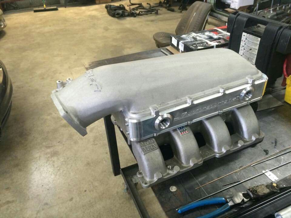

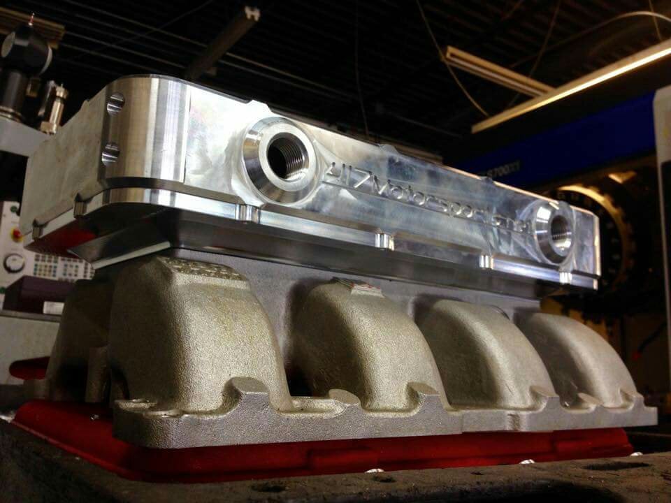

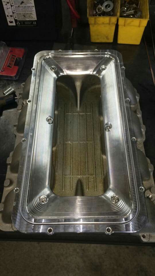

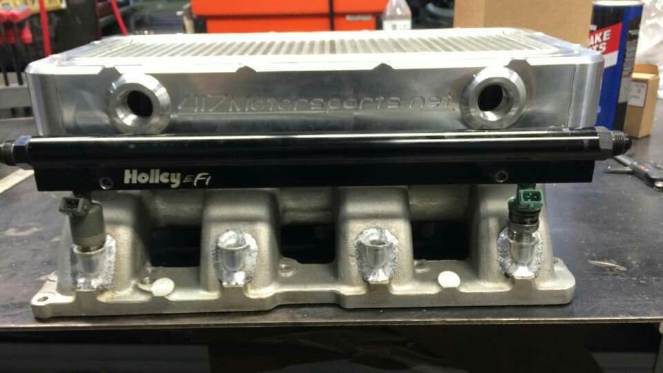

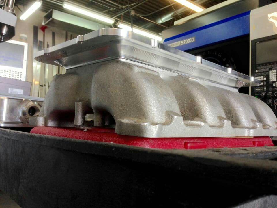

The intake is coming along nicely.

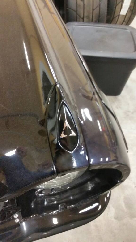

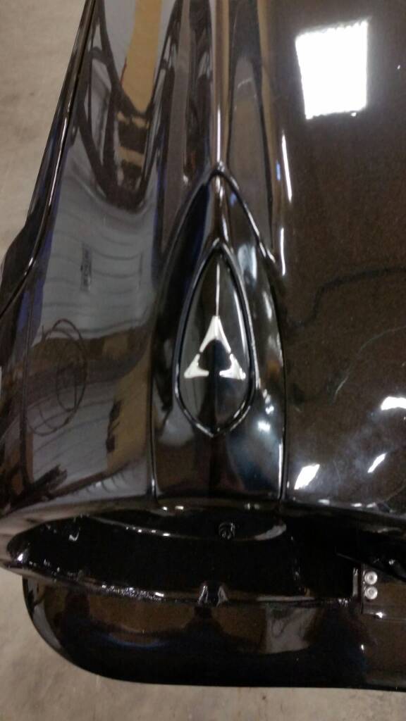

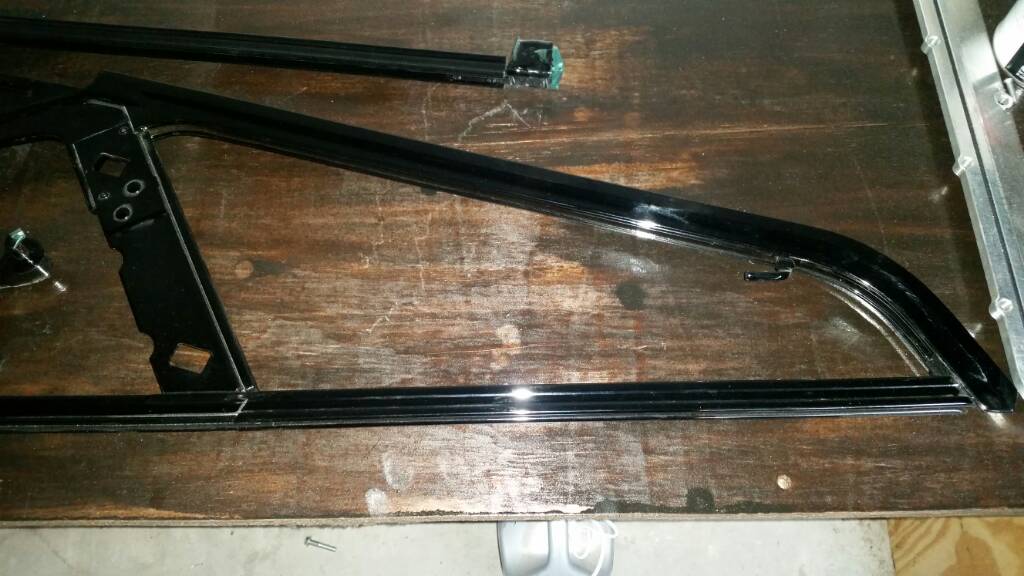

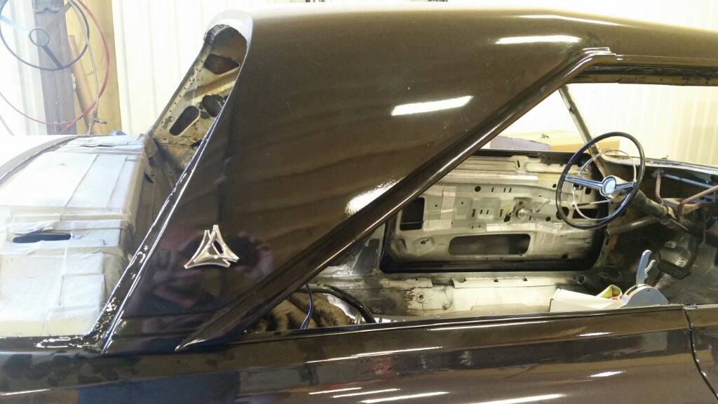

I got a lot of the trim back from coating. It was a lot of work but it turned out great.
