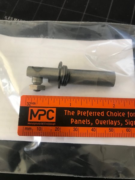

This is the cable connector inside the trans that connects the cable to the inner shift lever or "rooster comb". Does anyone know who sells parts like this? The spring is broken on mine. Thanks

I have that part in a 62 transmission and maybe in a 65 transmission but I don't think that they are the same.
Try A&A Transmissions or Cope Racing Transmissions
Terry1213 w.Hudson
The part# is 1673184 and it is used in all transmissions from 1955 to 1964.It
also was even used in the powerflites from 1955 to 1961. I went through all my parts books the spring is all the same part #.
Hope this helps
Jeff
'64 console shift piece is different than push button piece, but same as '65 piece.
Cope Transmissions, no response yet. A&A has just the spring for $25, the whole Assy for $70 used $90 new. Thanks for the inputs.
