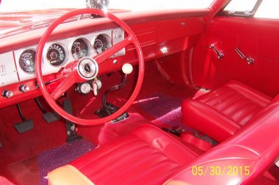

I believe you push in and turn counter clockwise to remove. Is this correct or am I doing this wrong? It doesn't seem to want to turn.
No you don't turn it by hand on 64 Savoy. Do you have a picture so we can see if it is the correct wheel and button?
here is a pic
horn button
It just pulls off. pry it from the back side carefully it is held in by an 0 ring.
Some bitch looks like a really nice 64.
More pictures please.
There is a slot on the bottom of chrome piece in the center of the button that a screw driver will fit in.
