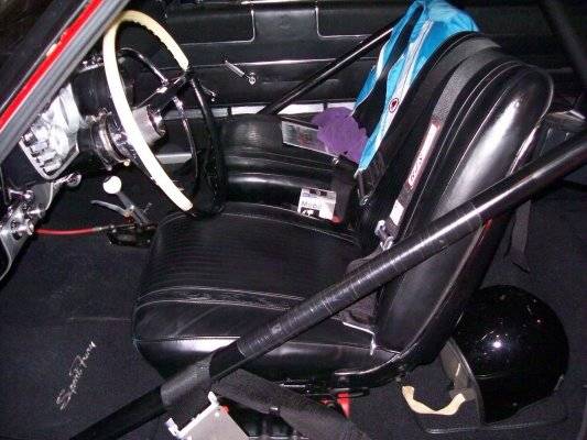

I run a 1970 style 727 trans in my 63 Sport Fury. I just use a B & M Pro Stick shifter and it works good for me. Been using this shifter since 2006. Ron

I have a B&M pro stick shifter. I really wanted to use it in my 64, but it just doesn't fit using the stock console.
You are right as I left the console out of my 63 Sport Fury. Ron

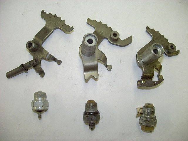

Just a guess but there are different rooster combs for 727's. Your later model 727 and the 64 shifter rooster combs have different part numbers and different detents. The comb is important because the detents must be the same as the shifter detent or they will not synchronize. The one on the left is for early model.
