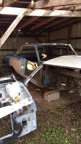

Here is the start
We had the factory instruction manual supplied to Amblewagon when restoring one of the factory cars years ago. All the jack brackets etc were cut off with an air chisel, very sloppy. The 1/4 panel finish was horible. Take a look at a original pic of the Sox & Martin car. All had acid dip steel, glass body parts that was very thick, sedan doors, no vent windows, long torsion bars, K head Hemi.
