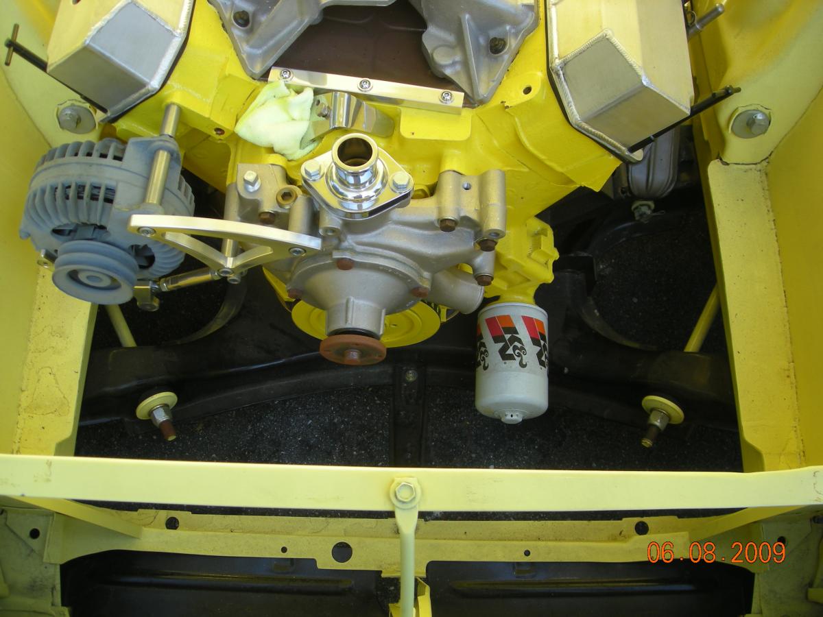

Lets see a pic !!! You have me very curious.. Here is my 64 Sport fury.

Darn it I thought I had the right pics of my 65 Coronet w/440 in it for you to compare. The heads are also offset. Can't remember which one but one is farther back and the other one is farther forward than the other. Is this what you are talking about? My motor also looks "sideways" but everything else lines up and the motor has never had any problems(bearings,vibrations ect...)

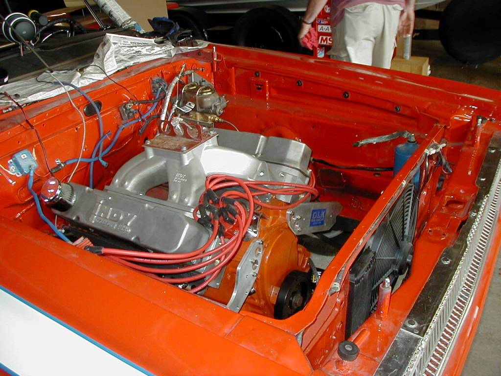

Don't mean to hi jack the thread but Moose what kinda of headers do you plan on running? I don't have the picture that is helpful to this thread but here is my motor.
