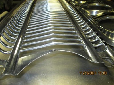

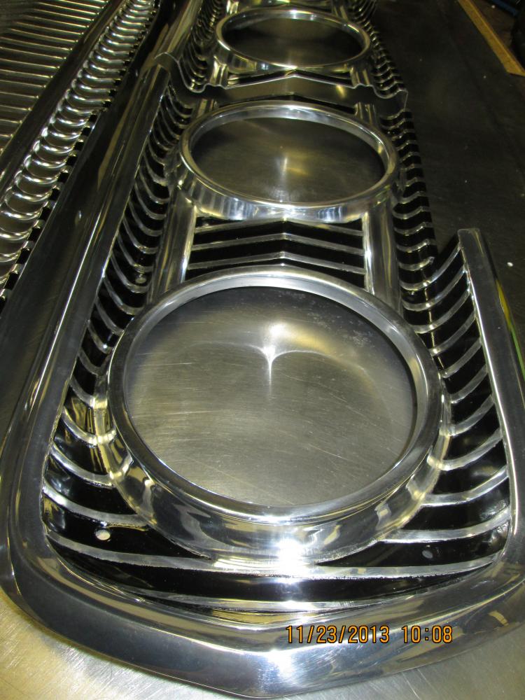

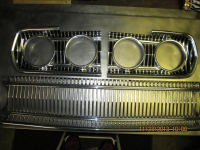

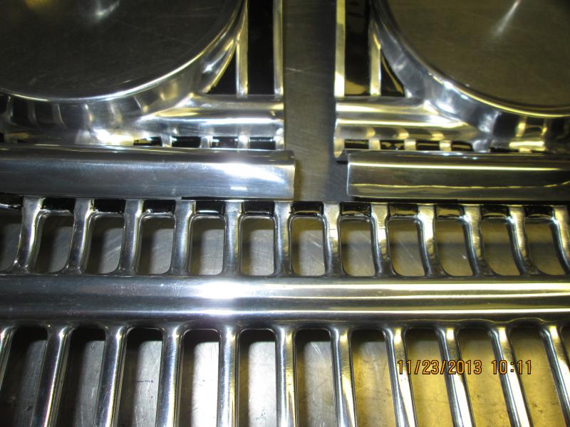

Finished 65 grill w bezels 001.jpgFinished 65 grill w bezels 002.jpgFinished 65 grill w bezels 003.jpgFinished 65 grill w bezels 004.jpg
Wanted to thank Zack again and thought everyone might want to see some photos of the finished product
Glad ya like it. Break is now over, get back to wrenching, lol!!
Curious what all you're using if it's not a "trade secret". LOL!
I strip with heavy duty Easy Off to remove the anodizing.
Knock out all the little dents and dings with hammer, dolly and assorted screwdrivers covered with layers of masking tape.
Wet sand with finer and finer wet or dry sandpaper.
Polish by hand with a micro-fiber towel and Mothers aluminum polish.
