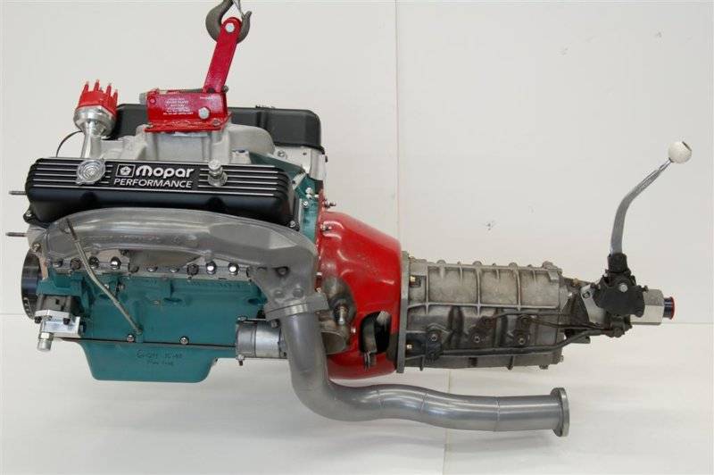

Here is a picture of the engine. Exhaust manifolds are from a late model B body car.

Those numbers through manifolds? Wow!
That's one happy camper of an engine right there. :)

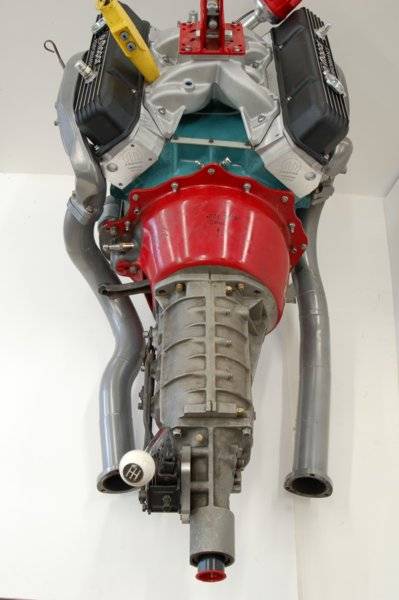

Man that thing is cool, really like those headpipes. Always liked the look of cast iron manifolds on big block mopars. Who did your pipes man thats cool.

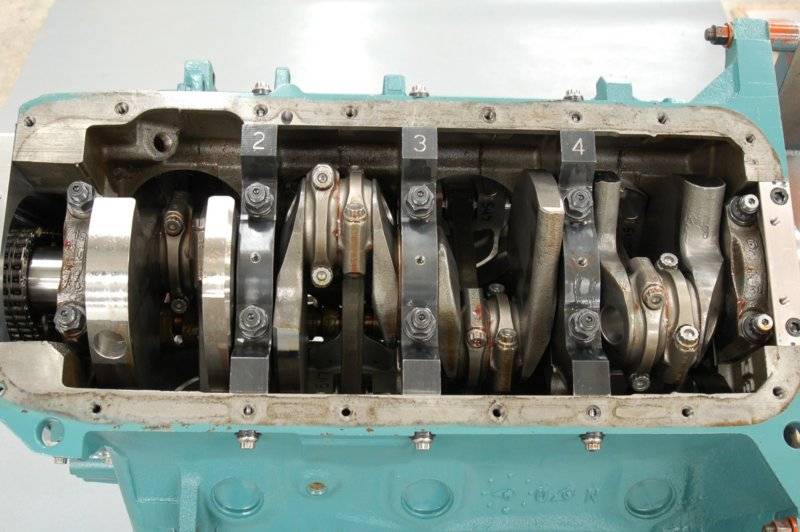

Andy what block are you using ? I see what looks like cross bolting ?
Factory 400 block that has been converted to 440 main bearing size and fitted with cross bolted main caps. (A lot of work by the way!)
Local fab guy welded up the pipes for me from a box of mandrel bends.

Love the custom machine work on the block! Could you post your dyno sheet? I'm going to be building a 512 from a 400 this winter. Did your power peak down in the 5500rpm range?
