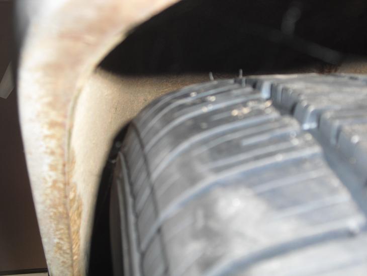

I recently had my friend's 275/60/15's on the back of my 65 Coronet Convertible. The wheels were 15x8 chrome Magnum 500's w/ 4'5" backspacing. The tires cleared all around, and did not rub. I drove them for ~ 1week, but there was only ~5/8" between the outer wheel well and the tire. I was scared that if I hit a big bump the sidewall would get shredded. I'm probably going to put 255/60/15's on it when I but my wheels and tires so I have a little extra room. This size will still fill out the wheel well nicely.

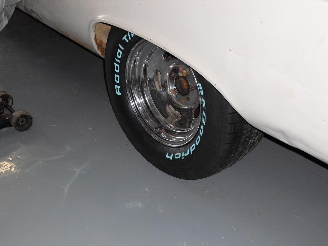

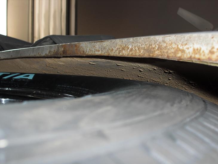

I finally got out to the shop and put this on the car to see again. It is a 275/60/15 on a 15x8 wheel 4 1/2 bs. Here are a couple of pics

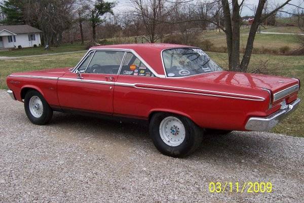

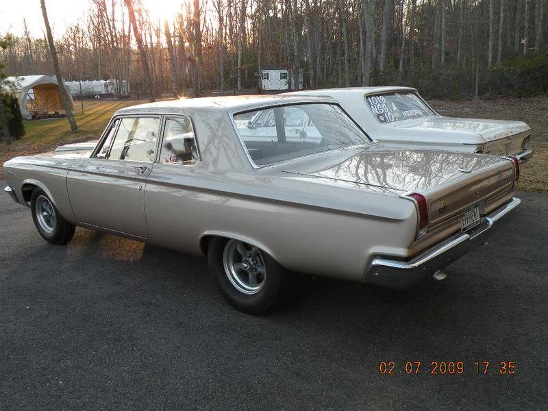

I have 275/60R15 on the rear and no problems at all. A little snug when i put on the 28x10.5 M/T slicks , but worth the fun !
Very nice. Is it mini tubed? Move the springs? what????
no stock location on springs, no minitubs everything stock, its all in the backspacing, those torque thrust d rear wheels were a stock item but outer rim was steel instead of aluminum.
Awesome. What size are the Mickeys and what about the fronts?
i believe they are 28 x 10.5 x 15 sportsman pro's mickey thompson's
front tires are from Coker tire, they are BFG silvertons, torque thrust d front rims 15 x 3.5

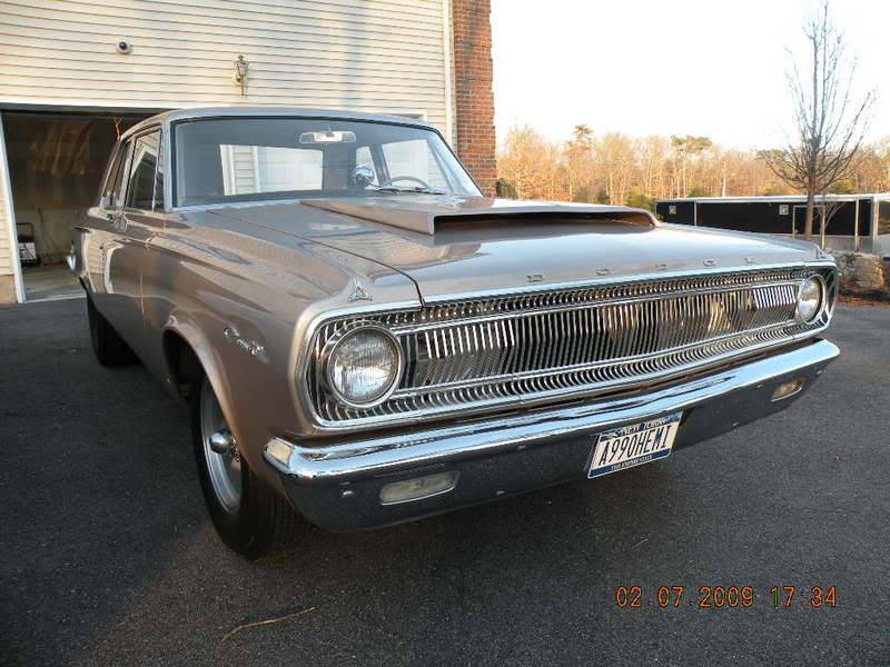

These Super Tricks are 15x8 4 1/2 Back space, With 15x10.50, Fit nice no probs.
