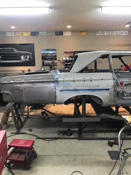

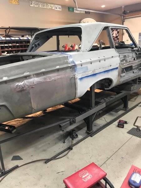

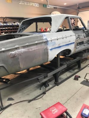

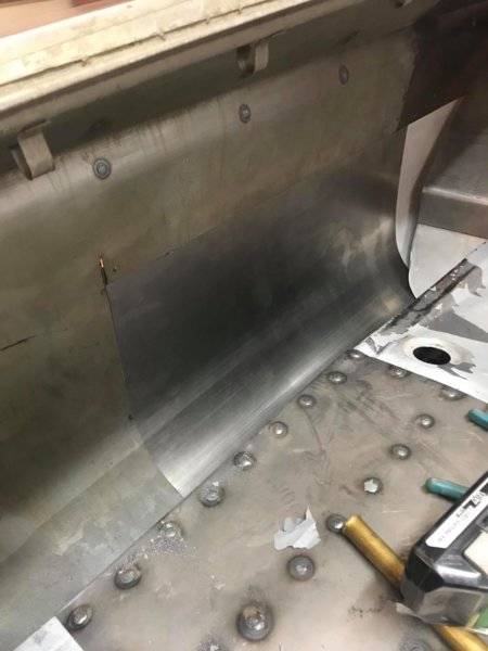

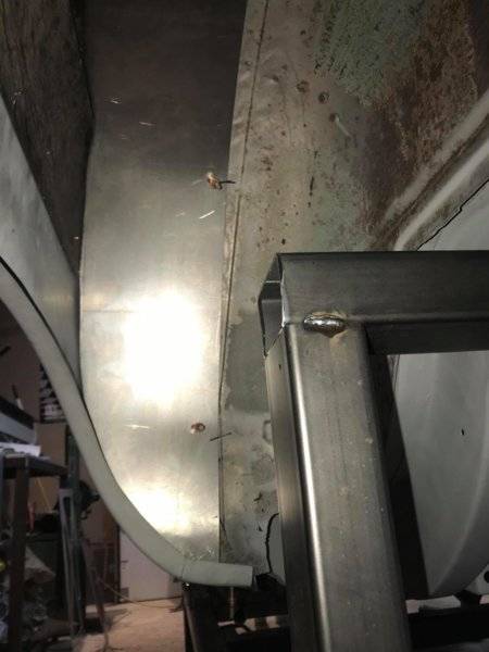

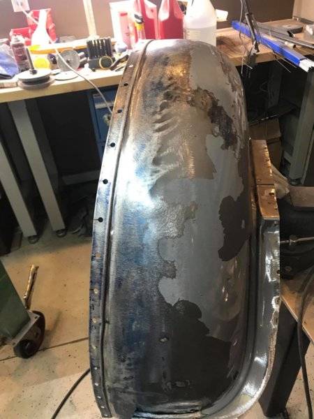

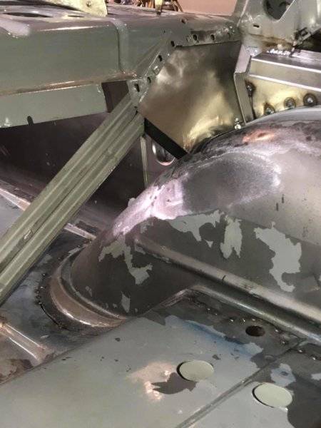

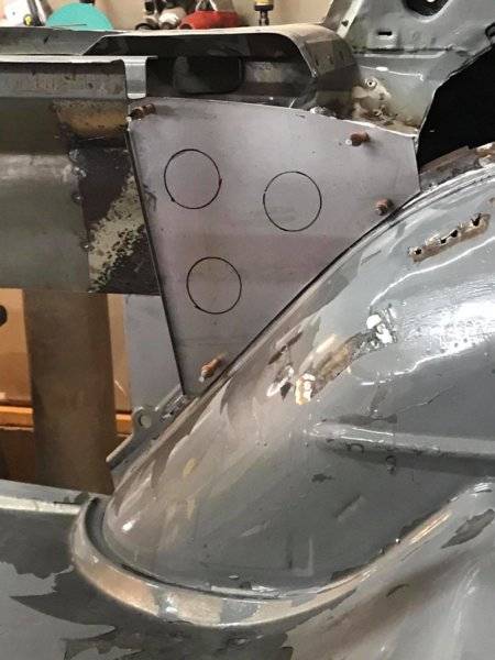

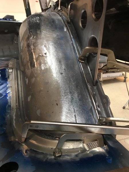

Widening the wheel tubs. Got the right one almost done. Trying to keep it looking "original" as possible . Will be able to fit 29.5 x 11 inch tire.
89367905_1426960897474758_1402893544741404672_n.jpg 89368327_600079090842496_8352639165019455488_n.jpg 89464237_1271362359920999_8606814079761252352_n.jpg 89716203_625256804697815_4668283976467611648_n.jpg 89972147_2547929822114755_3152226788030021632_n.jpg 90025040_2531031087151531_6172499785451307008_n.jpg 90037627_646591022825971_4730140868558716928_n.jpg

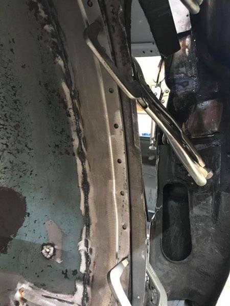

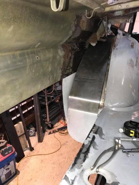

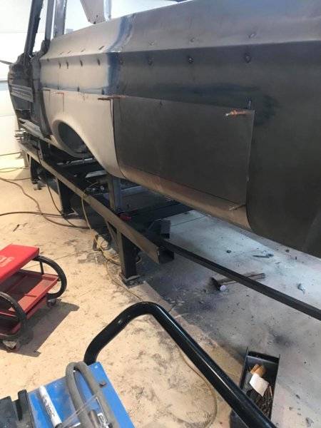

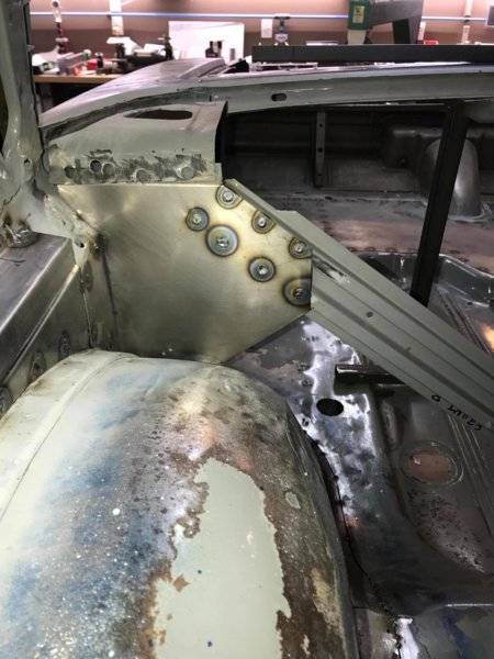

got the wheel wells done and the quarter panel patch panels made and tacked welded in. Coming along

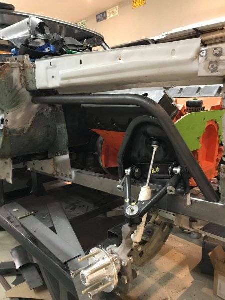

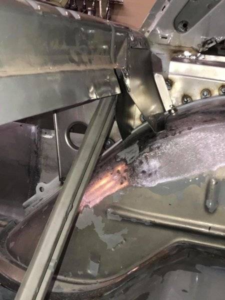

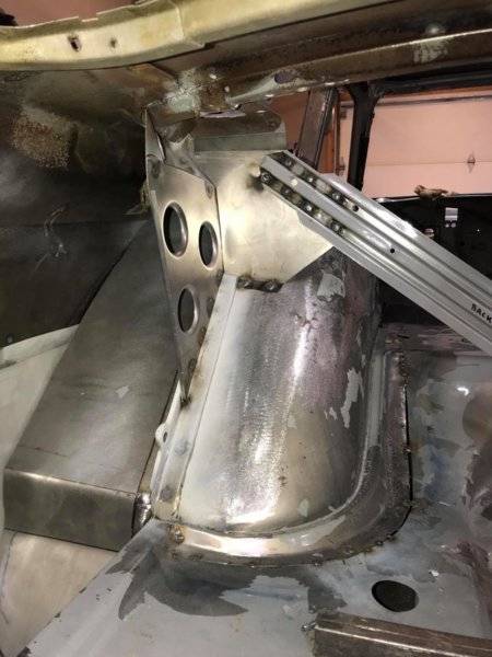

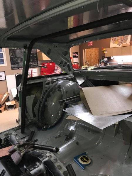

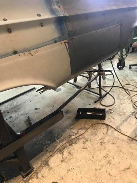

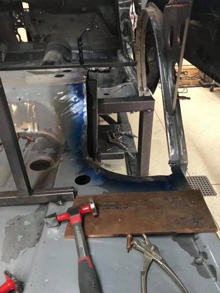

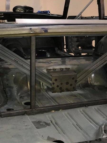

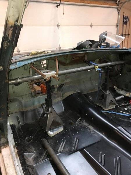

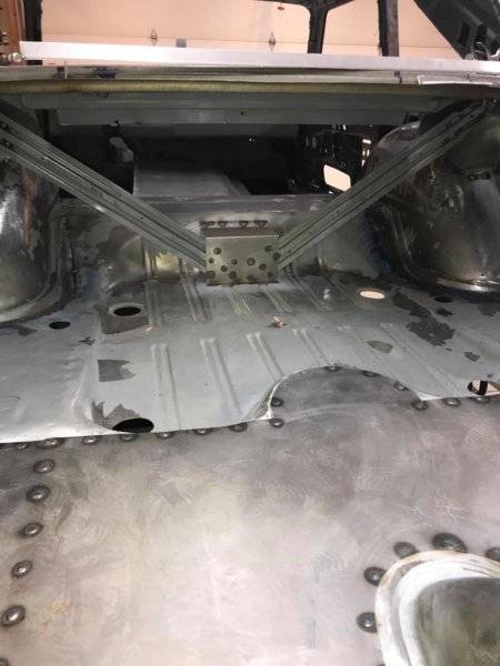

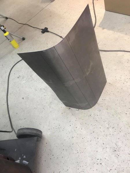

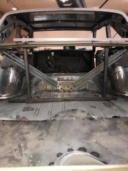

Got the rear supports in and finished welding everything. Now trying to get some CM tubing delivered and start on the roll cage. That is going to be a challenge. If we can't get the tubing we are pretty much dead in the water until the world opens up again. Going to step the seam on the new quarter panels and tack weld them in then have a friend of ours that can old school lead the seams like the factory did them from what we can tell.

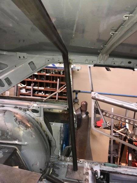

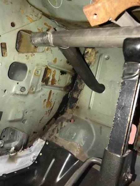

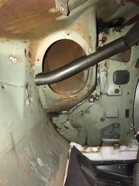

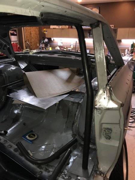

Getting going on the roll cage. Things are coming along. My Indy block should be showing up any day now.
