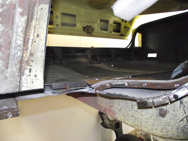

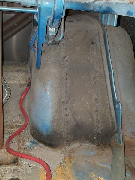

I'm not familiar with a 65s design, some pics of the wheel tub from inside the trunk and inside the wheelwell might help. But typically they are sectioned, split down the middle, or in my care just to the inside of the seam, the outer tub is moved in towards the rail and a filler (3-4")is welded to join the two halves back together.

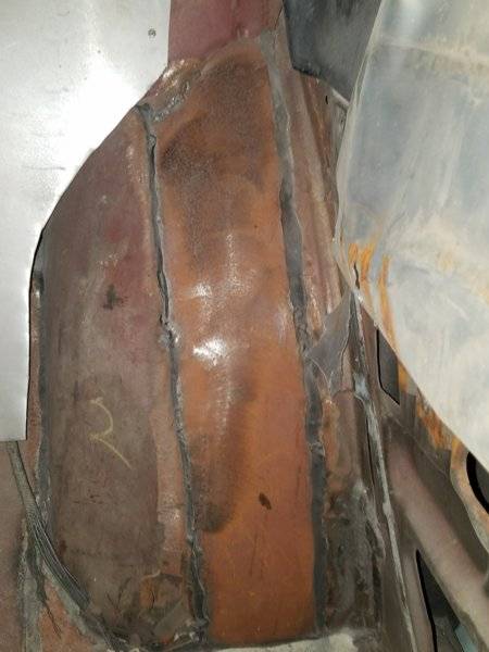

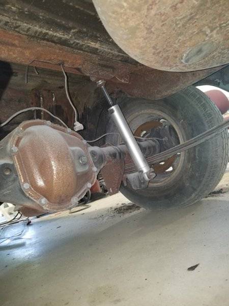

Pics are off of my 67 & I still have my back seat.
20180519_115156.jpg 20180519_115247.jpg 20180519_120321.jpg 20180519_120519.jpg

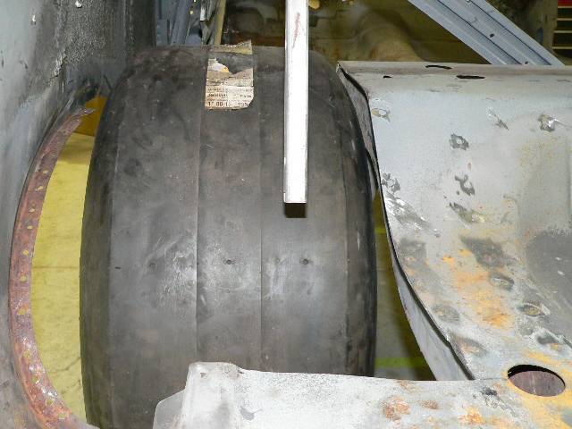

My 63 Plymouth has tubs That are fit to the 1/4 panel with the lips removed from the 1/4.The tub comes down on the inside flush with the chassis rail.With being said,mt street tire is an MT ET Street 16.5 x 31 that does rub a tad on the inside on certain turns and driveway aprons.I normally race with a 10.5W.

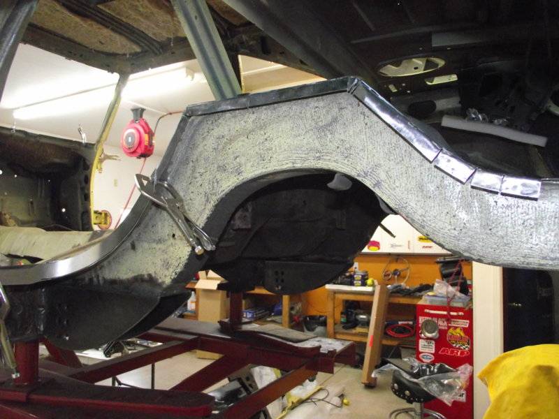

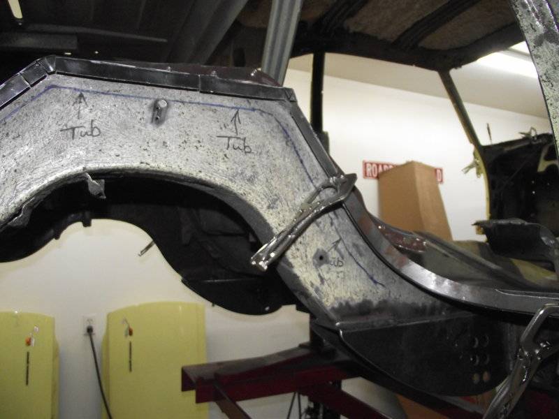

Got pictures documenting my mini tub work on my 67 Belvedere confrontations in my build thread . . .
Feel free to check out my work . . Even got the trunk brackets welded back to the tubs

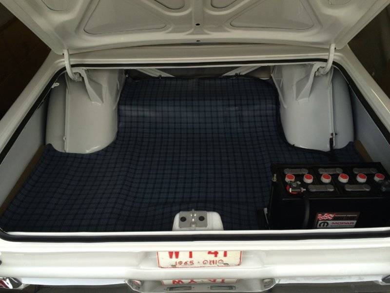

View attachment 665641View attachment 665656
Jeezx how nice would it be to have such clean wheel tubs???? I'm not looking forward to scrapping all the old rubber out from mine....
I haven't removed the rubber from the bottom of the 1/4 panels in 600 passes.
