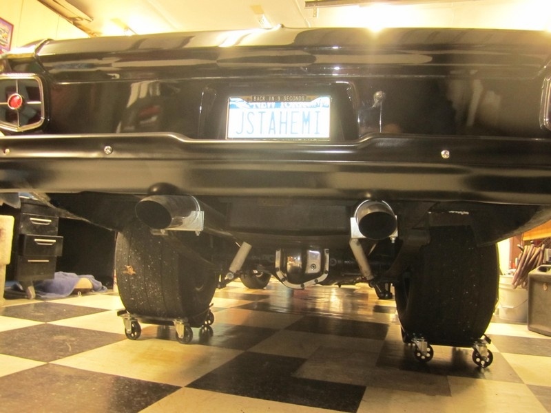

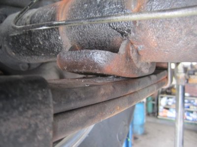

I have the same Dana and a spool in my car for 30 years.I did bend a perch once,if I were in the left lane I would have taken the tree down:lol:

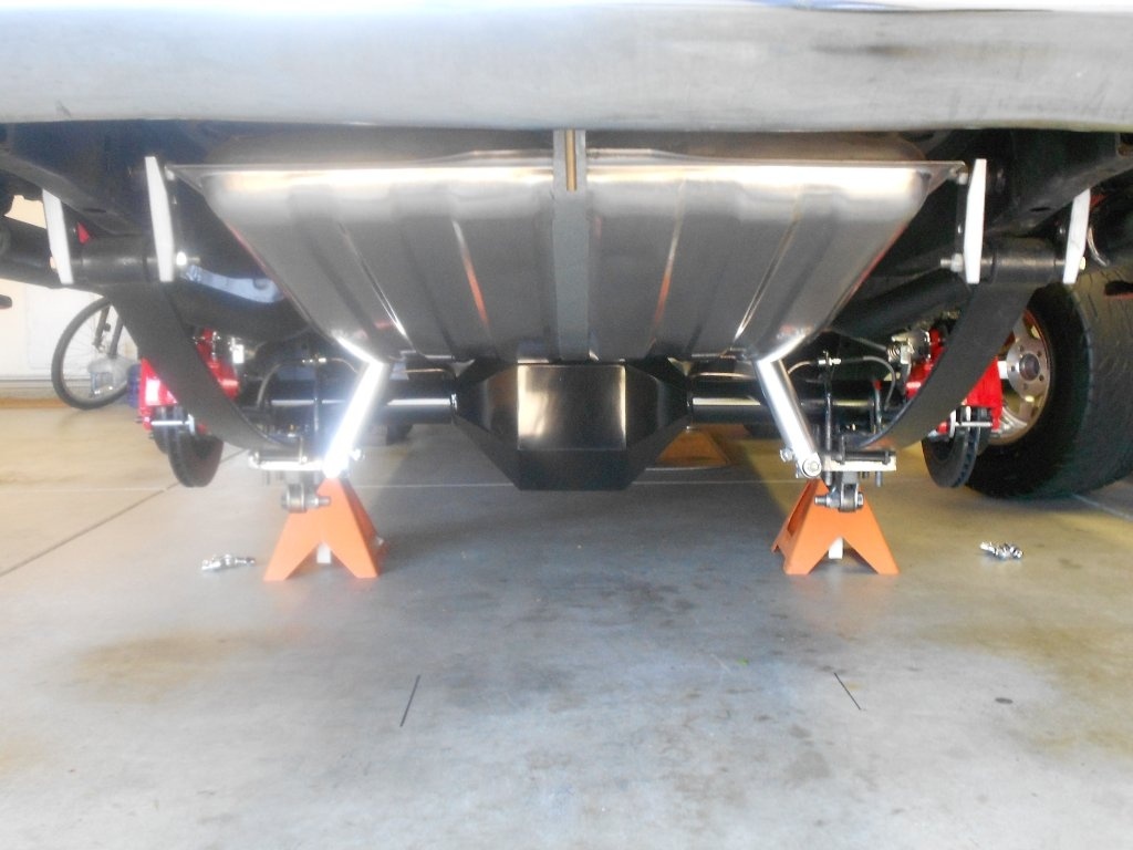

I scored a ton dually Dana rear axle, cut the ends off, put 8 3/4 ends on and did Dr. Different axles and a spool. All in I have about $950 in it after doing most of it myself and help from a couple of friends. I duplicated the width of the later B body axle for simplicity.

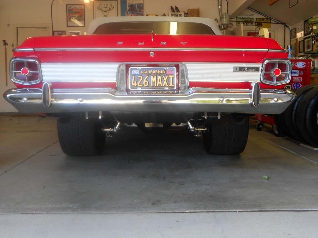

I installed a '65 Coronet housing/axles in my '63 Fury to dump the tapered axles and a '64 Fury sure-grip 3:23 now upgraded to 3:55 with some regret for cruising poly 318. My next step is to look at tranny upgrade maybe OD with engine rebuild..of course what I'm seeing on these posts are out of my league motor wise.
