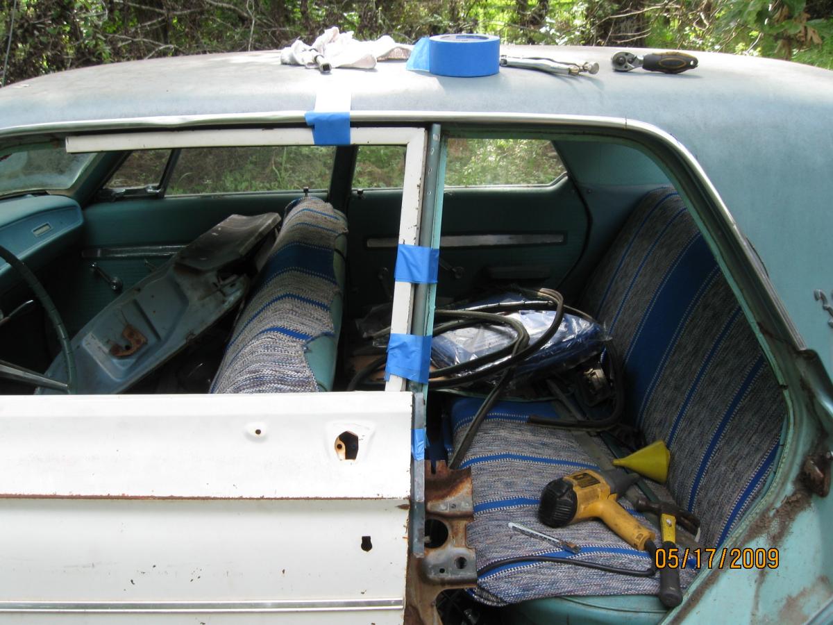

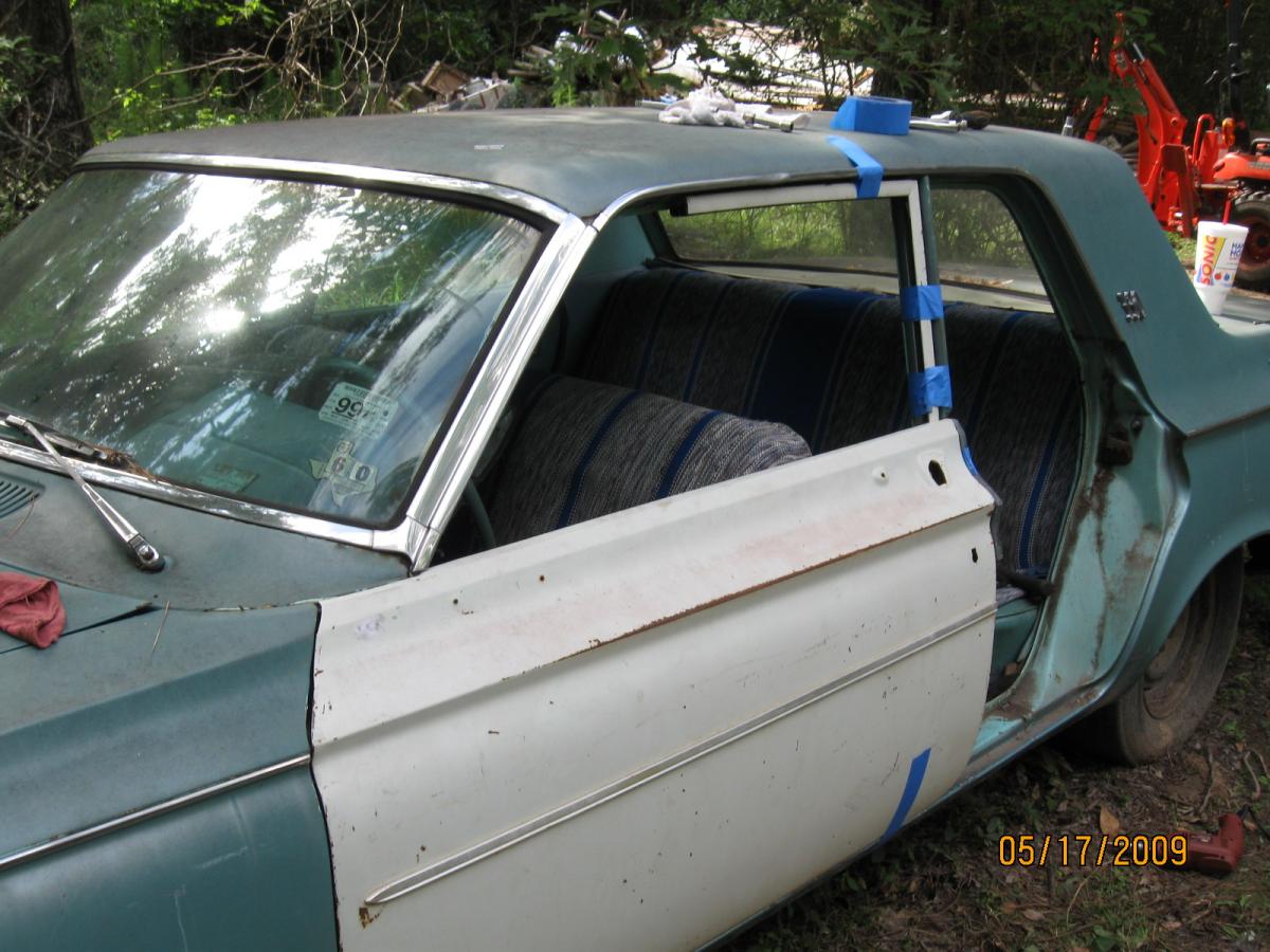

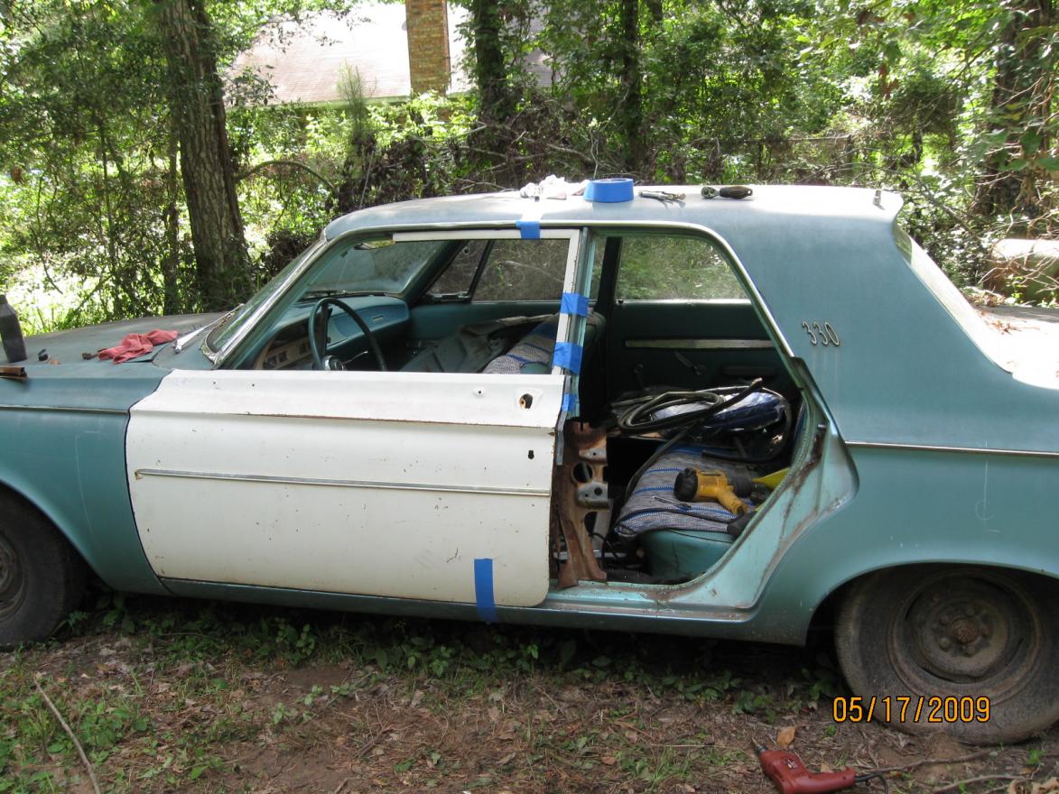

doors off a 65 will fit a 64 but to use them on a 63 the vent windows are differrent because the roofline is slanted on the 63. i have to cut them and use the 63 vent window but it will work
