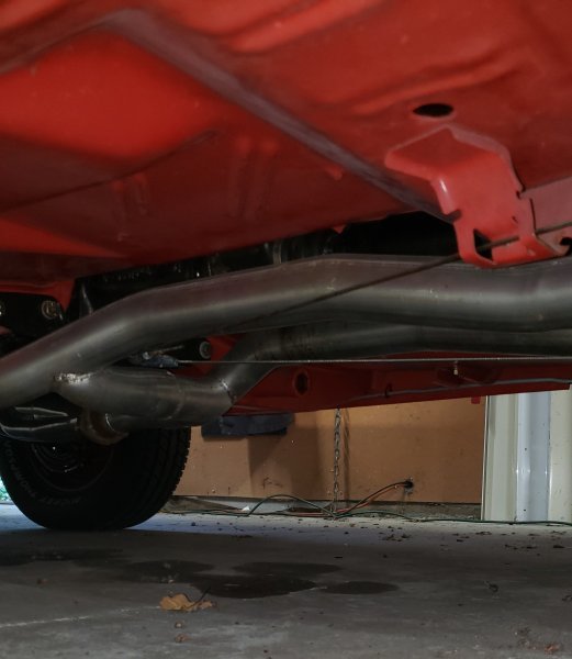

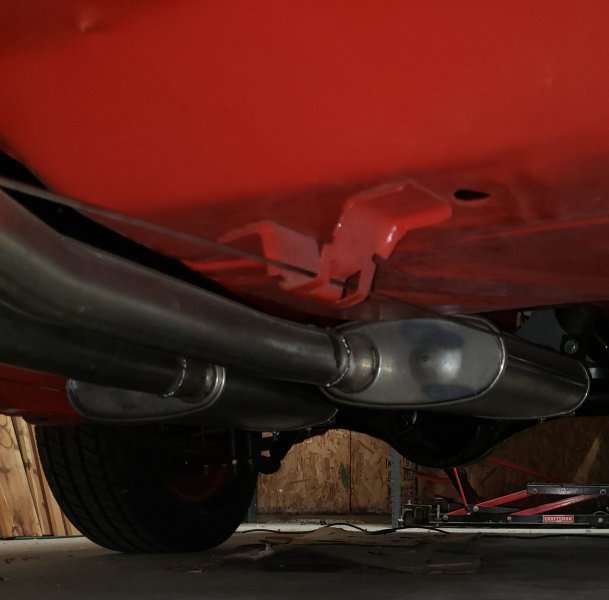

I've ordered a Pypes headers back exhaust (minus mufflers) with h-pipe back in May. Summit first had estimated shipping of 6-10. That came and around 6-15 it went to 7-9. Now it's 8-12.

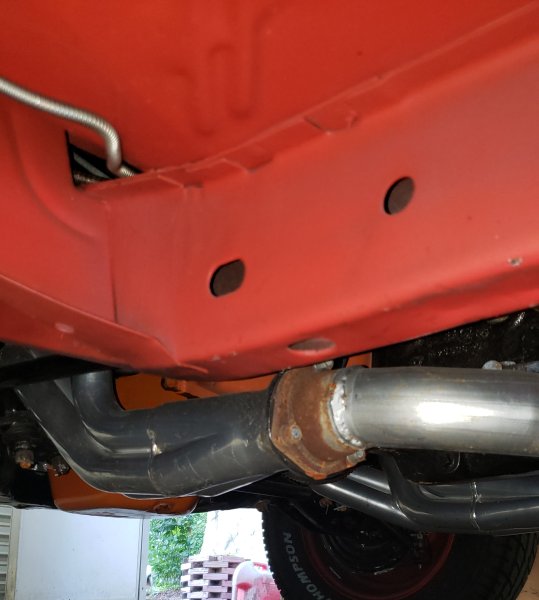

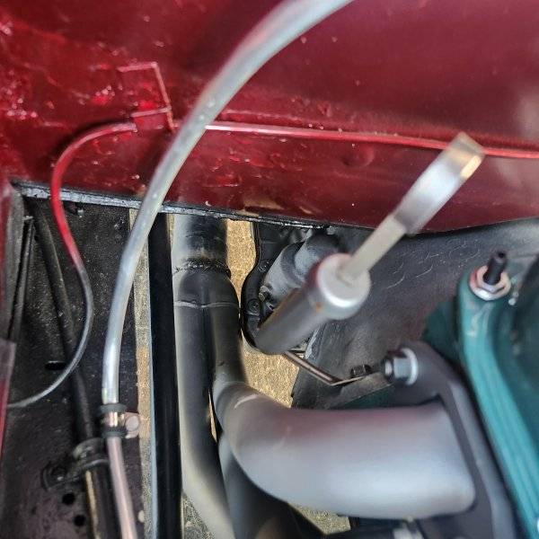

65 Coronet 383 TTi 2.5 .... Doug's headers. After install it went to a pipe shop for welding up to the headers.
Doug's headers do not hang down....Had some clearance issues on the Rt side.

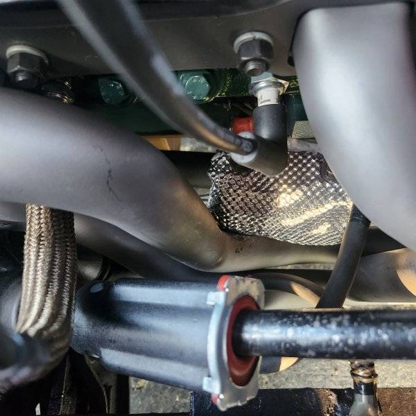

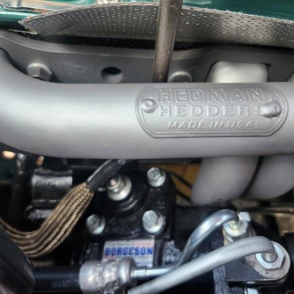

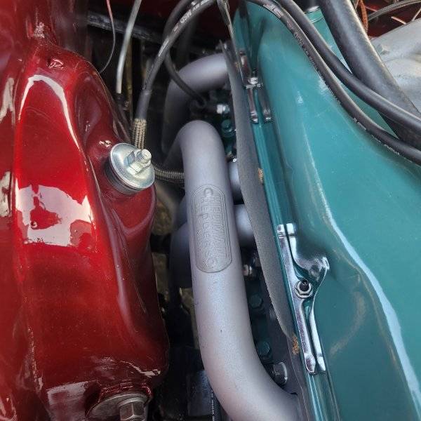

it’s a 383 but may help someone. Left side hit the steering box and the mini starter. Right side one tube hit the oil pan rail and and the trans pan rail. Some bending and beating and they fit!
