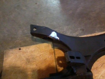

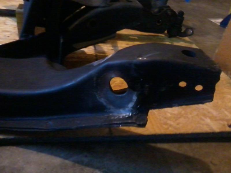

150225_002.jpg150225_001.jpgK member repaired! It was also smashed where the bushing sat against the K on the strut rod. Now I need to see about straitening these strut rods. Turned out both rods are bent.
I would suggest that you not try straightening the strut rods. You would be better off replacing them with either a good used pair or a new set. They are available in stock or adjustable in the aftermarket.
