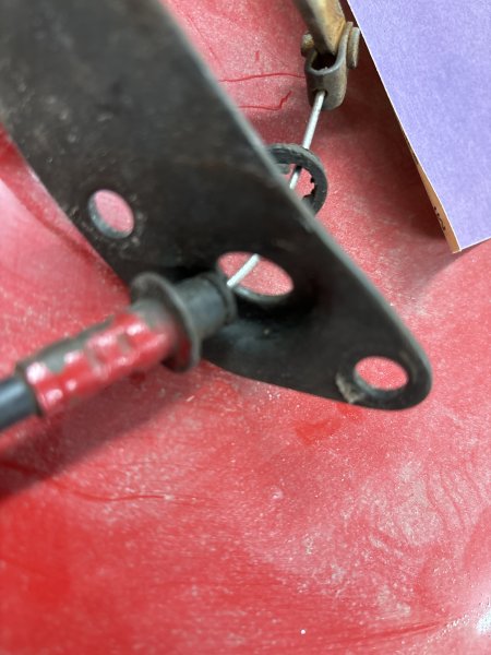

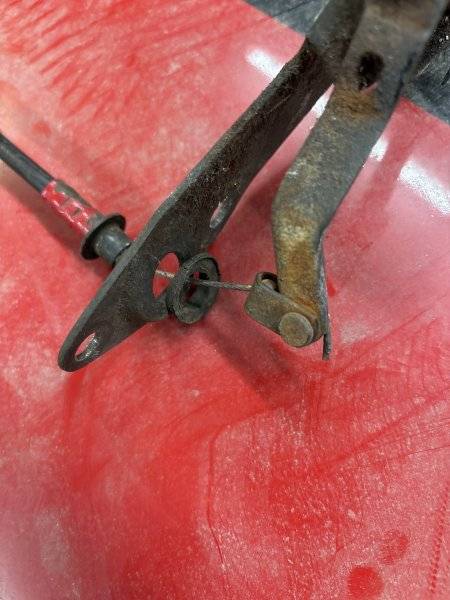

Doing a trial fit or some parts tonight. First Mopar and didn’t do the tear down on this car.
Looks like the bushing is missing from this part of gas pedal linkage ? Is this sold by a vendor or have you improvised here ?

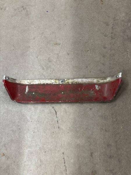

Also what is the 2nd part ? Was in a box and looked to be painted body color.

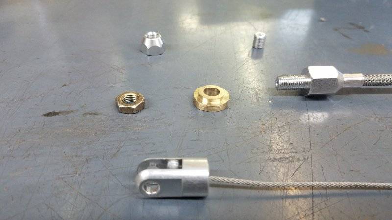

The rubber bushing goes around the cable where it goes thru the bracket. Then the E ring keeps the cable locked. Ive made them from brass. This is an aftermarket cable but you get the idea.
Doug

That goes on rear bumper below license plate.
