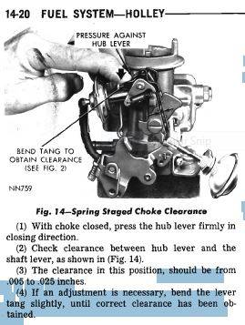

Well, yours being bent may have been an adjustment. If you read the service manual on how to adjust carburetor related items, "bend" this or that is actually the solution. I know it was with mine as far as startup.
Yours does look as if it was straightened, then re-bent actually.
Ahh, ok. Bending it to adjust it is likely why I wasn't finding a new one with that same looking bend in it. Learned something new today, thanks!
