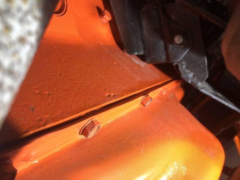

66 440 Vin pad?
ToddMcF2002
7:01 PM
Nov 3, 2021
236
50
Boston MA

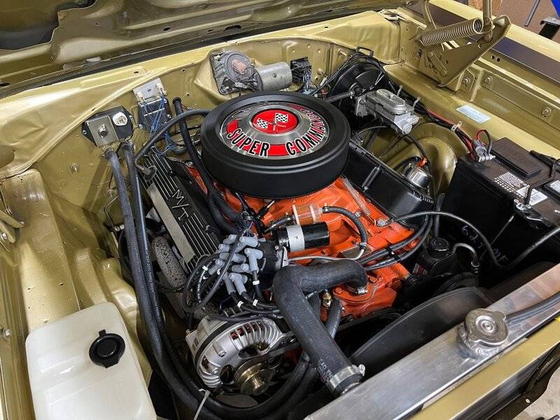

I’m not finding a vin pad at all where docs say it should be - passenger side above oil pan behind motor mount. I did check both sides. Can someone weigh in please?

Sorry forgot to reply. Its a 69 GTX with a 66 440. I'm assuming all the head stampings are under the valve covers?

Like mentioned there is no raised pad along the oil pan rail on a 1966 thru 1968 440 block to allow provisions to stamp a vin.
1968 has a vin stamped near the oil pressure switch( ive actually heard this started very late 1967 models depending on build plant )
1969 is when the oil pan rail vin location started.

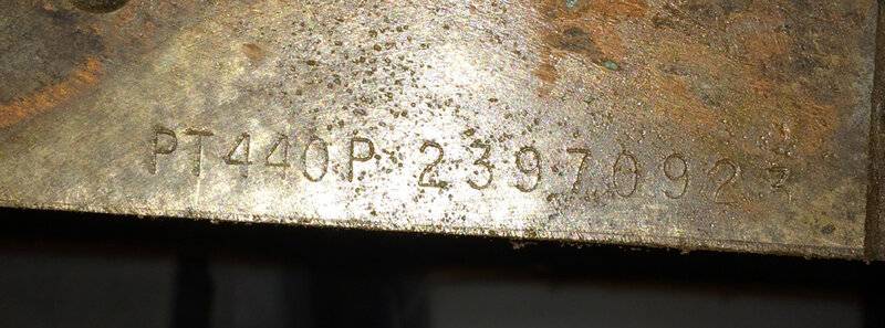

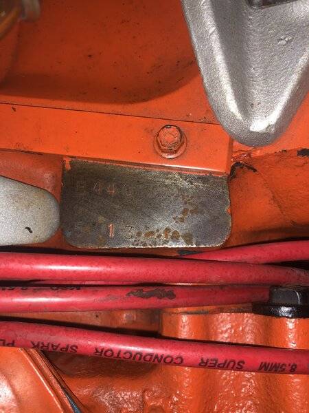

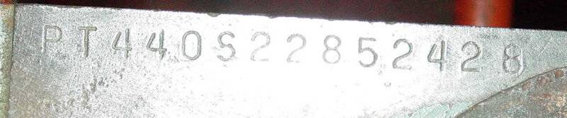

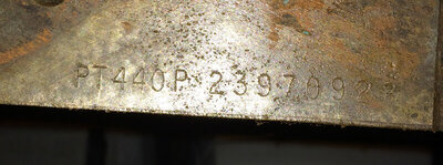

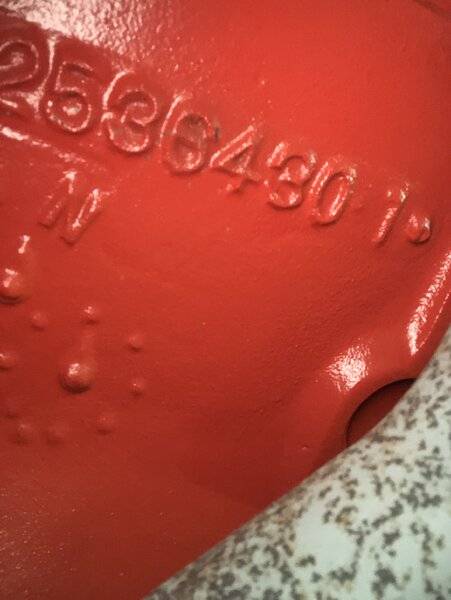

On a 66 block you should at least have one of these. On the pan rail near bell housing. P was a standard 4 bbl engine and S was an HP engine. First 4 digits are the build date.
Late 66 casting date could have been for a 67 R/T, GTX, or Charger as well as C and d body.
B 440
5 13
B indicates it' was for the 66 model year
Machined on the 13th of may 1965
