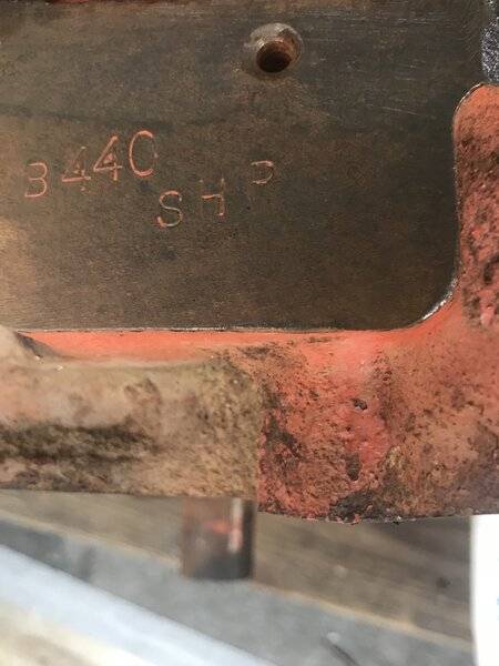

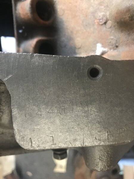

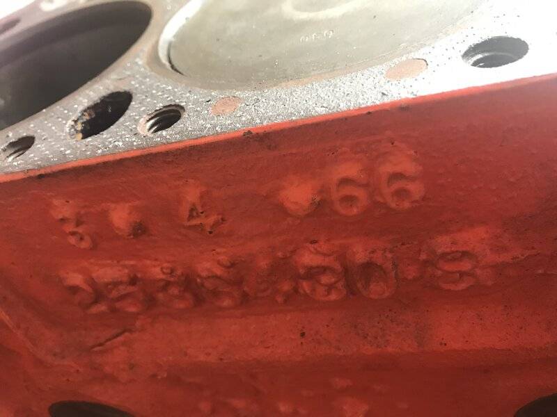

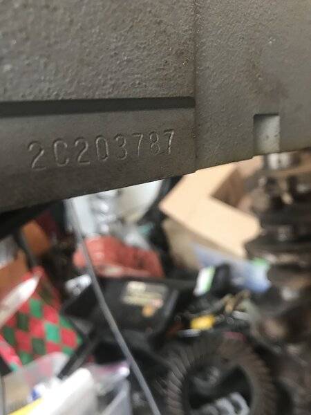

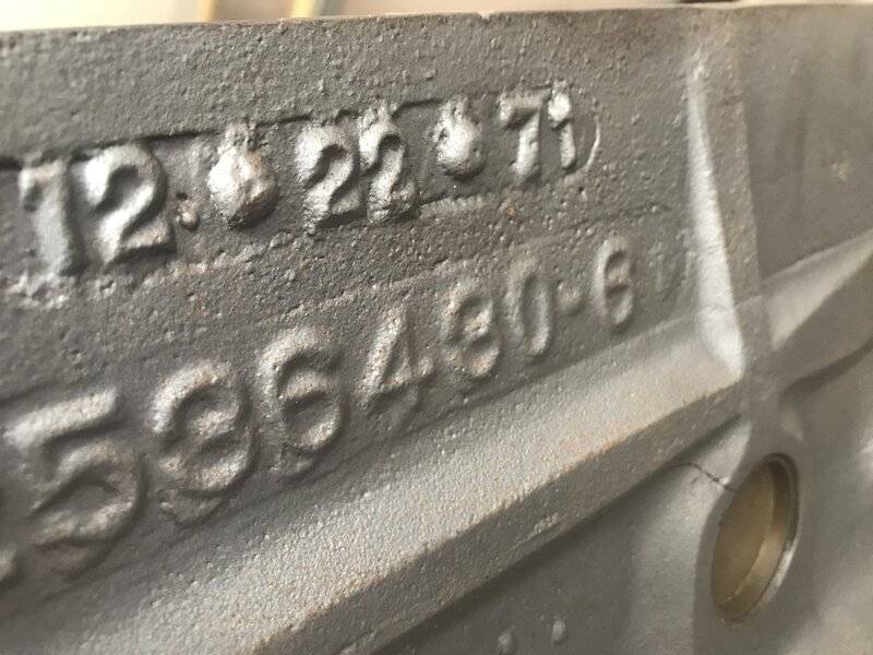

Photos attached, the 66 has a blank pad
A5DDA265-66DC-4BD5-A37D-059193D1EE23.jpeg 75EBC1FF-ABC6-4D83-8558-8F8AFE136400.jpeg E5895E69-361B-4CBD-BB0F-E21B76426725.jpeg 66E4A198-84A5-454D-909B-BAA41EC6F133.jpeg 45ADBB88-2BEB-46DF-88D9-09EF8DCA7E92.jpeg B3F4E26E-C073-48F1-8399-DCF4BB8151B0.jpeg
That 66 engine is very interesting. I have never seen anything stamped SHP. Your 71 casting engine is a 72 HP by the H 440. Maybe someone else can elaborate on it. It's definitely a 66 by the B 66 and would be correct with no VIN stamping. Thanks the pictures are as they say worth a thousand words. Are both these engines just the short blocks? Your 906 heads would be correct for 68-70. The 66 more than likely would be 516's and the 72 more than likely 452's. Both are unique as there were not many 72 440 HP cars, and the 66 by the stamping on the pad. Still both are just buildable cores. I say 3-6 hundred on the short blocks. $100 on the stock 906's. Maybe a little more on the ported 906's depending on the quality of the work. Please remember, just an opinion, some may say more. The guy at the end of the rainbow that has the car to go with the VIN on the 72, who knows.

Maybe the change from 516 heads in 66 to 915 heads in 67 made the 10 horsepower difference. I just have never seen a HP stamp on a 66. I never say never.
The other odd thing is 68 & earlier doesn't normally have the raise area on the side where the VIN gets stamped...
The 71 cast engine came from a 72 C body, the VIN begining with 2 means 72 Model Year & the C means Jefferson assembly plant where they built C bodies..

Yes the 71 casting is a 72 model year and would have come with 346 heads. 452 heads were 76-78

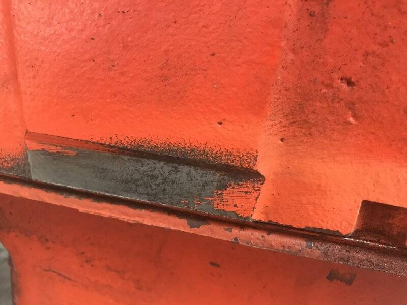

Had to run out there and check, scared the hell out of me, that pic does look like a crack, think its a line of shellack from the FP install lol
