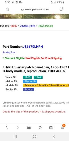

As stated before, there are currently 2 different patch panels on the market.
One is fair
The other is total crap
There is room for a full length panel with AMD quality
I also would be interested in panels for my '67 Coronet.
One is fair
Which one is the better of the two please?
the fair one has the curves stamped into the panel
the crap ones does not and is totally flat
that's the easiest way to tell them apart
side by side the difference is extremely easy to see
