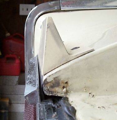

66/67 Dodge Charger Spoiler
That's sweet. I would be interested in a fiberglass model if someone produces one.
the originals were made from solid aluminum, 'glass will not work, it's been tried, many times....the leading edge is so thin that when you go to attach it to the car, it will crack. I'm still working on getting a second run of this item in the works, it will probably happen over the winter if I can find a company to work with for a reasonable price
do you have a measurement at the side view? height, and length? it almost looks like there rivited on to the deck lid.. true?
the original pieces from Chrysler were attached to the car via sheet metal screws. I attached the spoiler pieces to both of my cars with machine screws with ny-loc nuts under the trunk lid and quarter panels
cool thank you.. is it safe to say it measures what a 1 1/2" high and that long?
A383Wing. Let me know when and if you decide to produce the spoilers again. Also let me know if you ever decide to sell a copy of a CAD drawing of the spoiler as it would be kind of cool to manufacture one of these dudes out of a piece of stainless. Getting the deck lid arch is what will separate the men from the boys on trying to build one.
I need a height and length im pretty sure by the pictures it 1 1/2"
