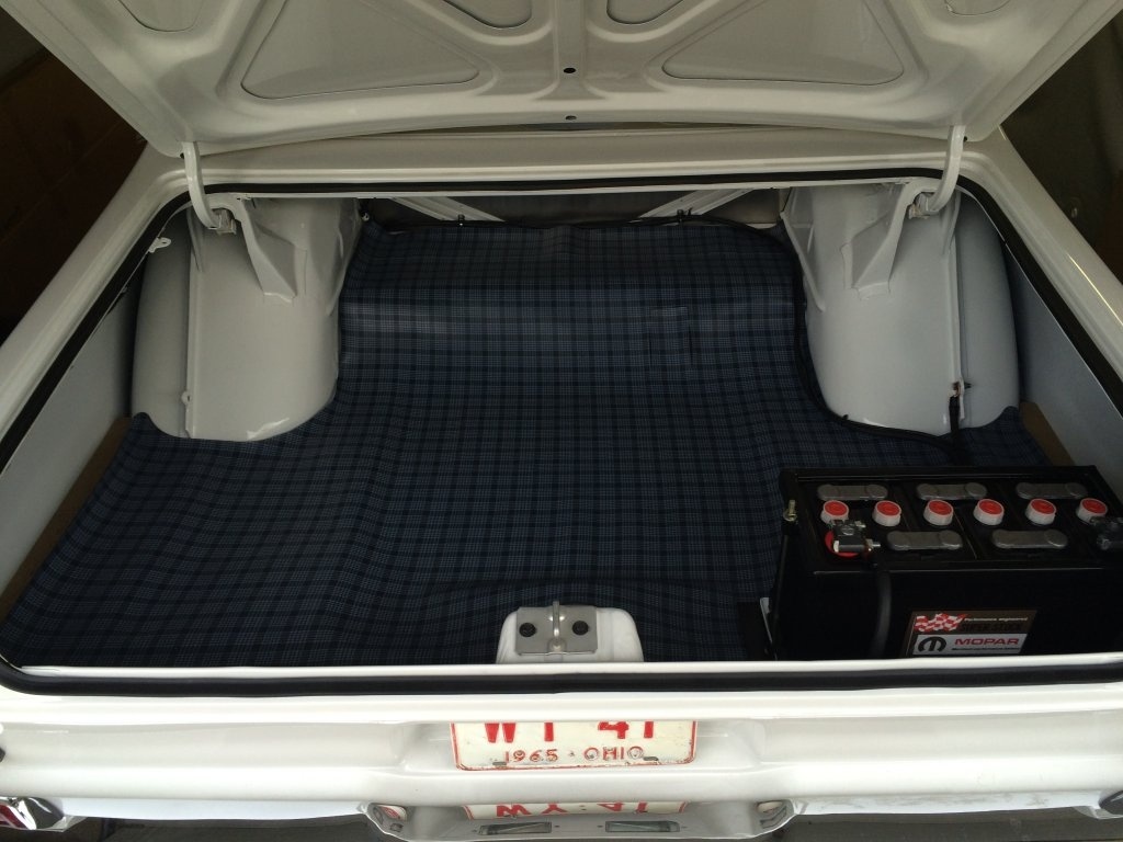

I relocated the battery in my '65 like the A990 cars. No kit. Used welding cables, terminals, and master shut off switch. Goes on the passenger side. Wire the alternator into the shut off switch. I have a terminal block under the hood.

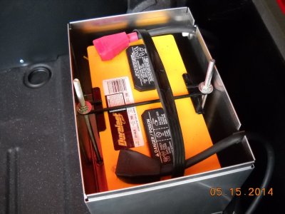

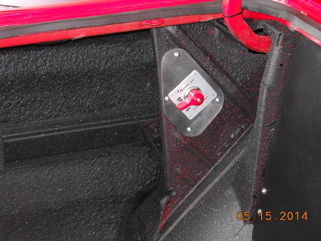

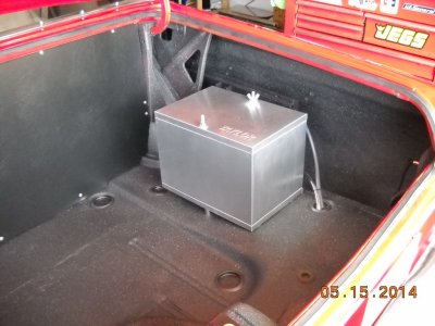

All good info: You can buy all the wiring components from Del City Wiring at pretty good prices. Summit or Jegs have the box.
