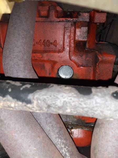

Got the axle out on the passenger side which was a bitch. I have to figure out why it was stuck in there and fix it and replace the seal. I got the kickdown linkage on the 440, and I realized I need to work on my painting skills. Got the leaking freeze plug out as well. Need to get it replaced, then put the starter on and header back on.

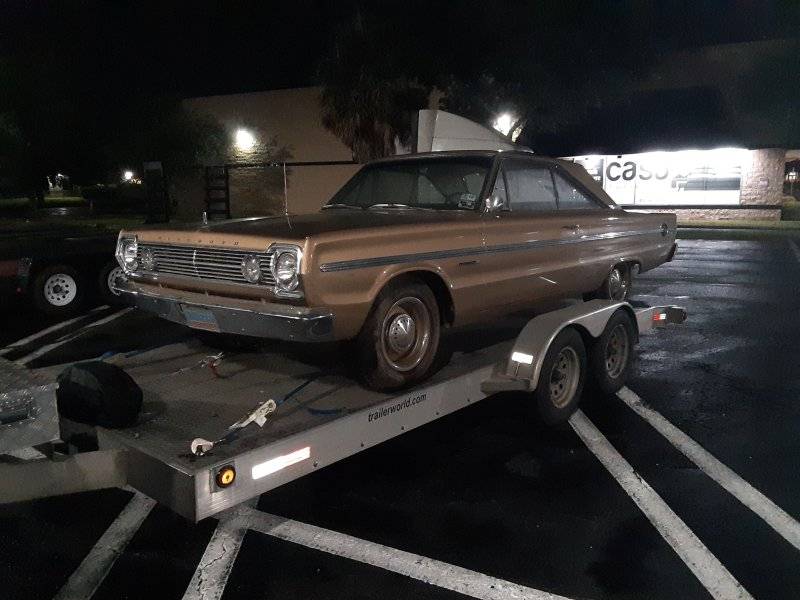

Any pics of the car or a back story ? Or am I to late to the party the thread starts out with pics of heater hose brackets?
Sorry. I pulled it out of the same barn my coronet 500 came out of. It's led a hard life, been stripped of all things hemi, unfortunately. It's had a shoddy resto done in the 90s looks like. Here are some pics when I first got it after we pulled it out of the barn a year ago.
After 45 minutes to an hour of f@#*ing with this thing, I finally got the freeze out plug in. Had to use the install tool, but the handle wasn't long enough so I had to use a chisel flipped over to extend it out far enough I could get a hammer on it. After it flipping all over the place and cleaning the plug off and reapplying the sealant over and over,I finally got it started in. Used a couple different combos of adapters to get it seated into the hole. Glad that's over. Got the rear axle seal swapped out and figured out what caused that to be such a bitch to get out, they sealed the race into the housing with what appears to be permatex 1 or something similar. I used a wire wheel on a drill to get it cleaned up. Housing is a little corroded as a result

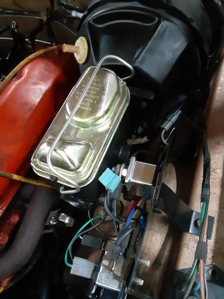

I was working late in the shop last night, weather went from 92 on Wednesday to 67 on Thursday and 65 on Friday, so it was decent working weather, and I was hoping to get this wrapped up. I got all the engine wiring and stuff hooked up,heater hoses,etc, so I decided to start it up. I got in and hit the key, nothing. Went to the relay board, and since nothing is marked and I didn't have an old one to go buy, I had the ignition and horn wires switched, lol. I swapped them and it cranked over and eventually started. I shut it off as I still needed to put coolant in it. I dug my fresh booster out that Booster dewey redid for me and slid it into place. I climbed under the dash and got the 3 nuts back on, still need to come up with one more, but that's what it had when it came in. I got out from under there and scoped out how it looked under the hood, and that's when **** went south. I thought, man that looks awful close to the relay panel, so I grabbed the MC and tried to slip it on. Crap! Nothing some red label Weller couldn't handle.
Thanks to Richard Cranium and Fran, I think I have a solution. I'm going to try it after while.
