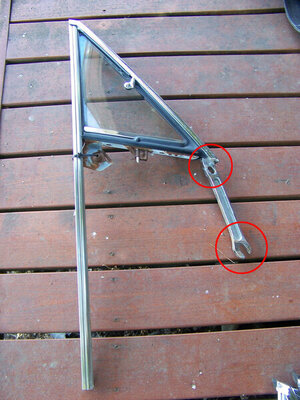

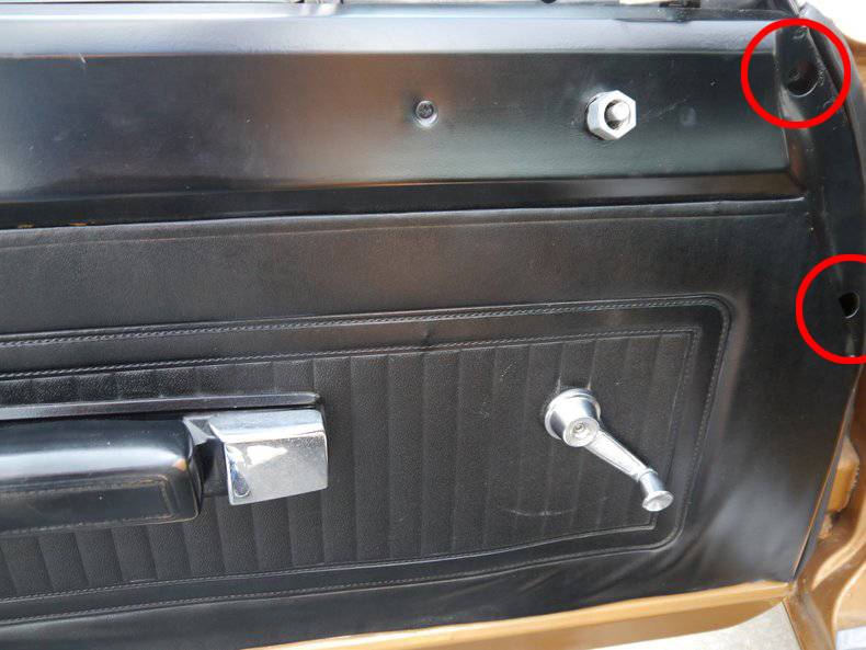

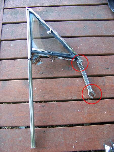

I'm trying to rebuild the window mechanisms and can't seem to find the info needed in my FSM.
I've replaced the front doors from a parts car. The doors came completely void of any hardware or mechanisms.
The hardware I have is from my original car. The pieces were removed about 5 years ago and I failed to take reference pics.
The question I have is this. I seem to recall the opening on the lower front most bracket (see pics used from the web) slid onto a mounting bolt of some kind and allowed for adjustment through holes in the front of the door. Also I believe a bolt was used on the upper hole on that brace.
Can someone please tell me what I'm missing - parts or otherwise.
Thanks.

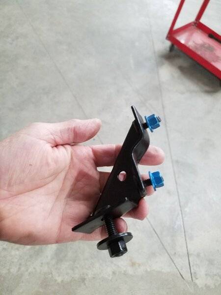

This piece bolts in your door and secures the lower front.
Thank you. I just looked at my parts guide and saw that. Now I have to see if I can find it.
