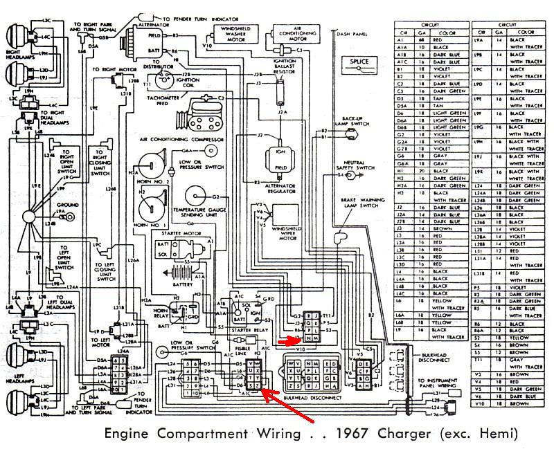

Most likely a problem with bad connection in the bulkhead connector. See the attached picture with the red arrow. Terminal "Z" is where the battery voltage goes into the car and the rest of the system. You can easlily check it from the engine compartment.
The other weak point is terminal "P" which is connected to the alternator.
These 2 terminals easily overheat and melt plastic when the connection is bad and the resulting resistance is high.

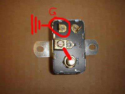

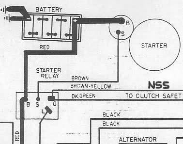

the starter relay needs to see a ground, whether it be through the neutral safety switch, the clutch safety switch or the case itself depending on the year. you can directly ground the starter relay to the body , but it will start in any gear. check for power at the relay by crossing the power to the starter solenoid.
Good thought, but if you have no power to anything in the car it would not be the relay. The relay is only to energize the starter.
I have to correct myself...the bulkhead terminal connected to the alternator is "P", not "N" as I had written previously. Sorry.
