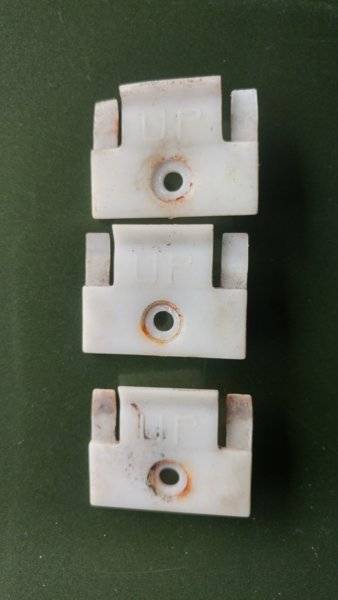

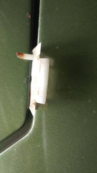

5ADE9B6D-35C6-4769-909F-DB9E67BBDA35.jpeg 24E3BEEB-88F6-4DCC-904E-CE9992C1BE09.jpeg
If you can post a picture of the originals and the reproductions that your using, I would be interested in viewing them. We have sold multiple sets, so I am wondering if there is a different one on the market. I know that the 67 Plymouth clip that everyone sells is actually a 67 to 72 Ford truck clip, but it actually works semi well. Thanks for your assistance.

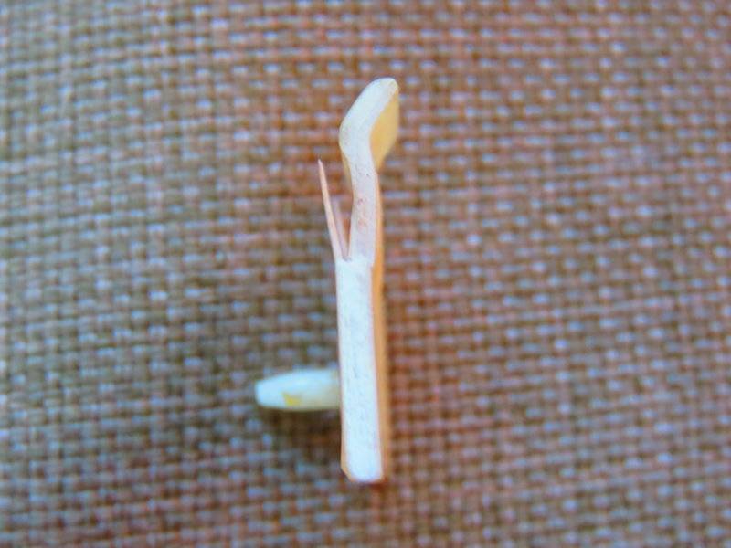

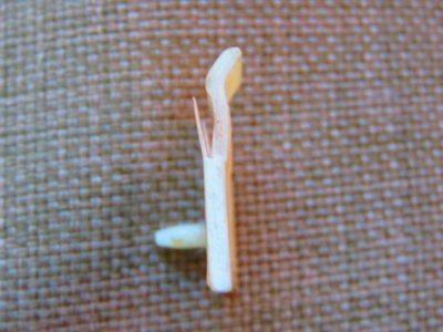

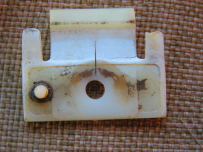

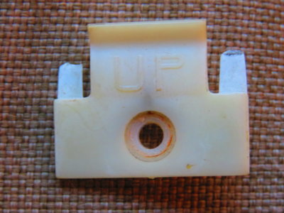

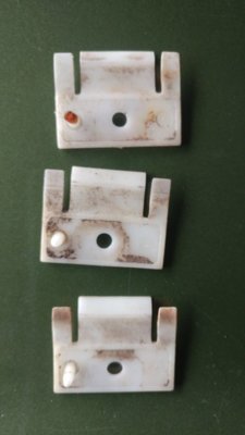

This is an original 1966 Charger rocker panel stainless steel molding clip. The portion that hold the weight of the trim goes pretty much straight up. The reproductions angle badly toward the body. As someone said earlier, the only way to make them work is to shim them out. I looked at rt specialty clips and they are the ones that aren't correct -- you'd scratch the paint badly trying to force the trim down onto the clips. I bought a set from The Mopar Shop and they were also engineered incorrectly.
Thanks for the pictures. I now see the differences between the originals and reproductions. I only know of two different people doing these clips and they are basically copies of each others and would have the same issue that your experiencing.
It's hard to believe this hasn't been a bigger issue. As far as I know, the stainless rocker molding on the 1966 Charger is the same as the 1967 Charger and the 1967 GTX. A lot of those restorations have been done -- are people shimming the incorrect reproductions, forcing the stainless past the clip scratching paint, or what. I'm now looking for a minimum of six original clips. I was fortunate -- during removal I only broke six.
