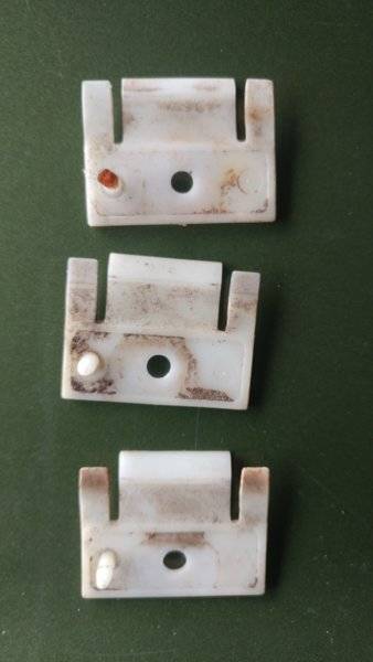

Do not over tighten the clips. If you see cracks around the screw hole in the old ones, someone was too aggressive. Plastic behind the tops of the repos works well.

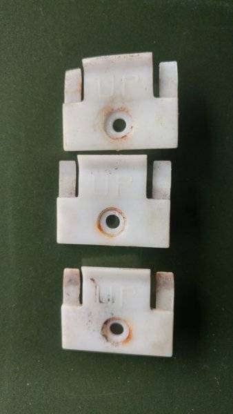

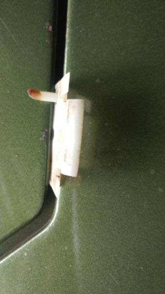

Is it just me or is anyone else finding that the rocker trim clips available don't work? Either that or I'm going crazy. I ordered two sets of clips -- when screwed to the rocker panel the top that hooks to the stainless trim is way too tight against the body. It would definitely scratch the paint trying to push the stainless trim into the clips. I turned the clips around and then they're too loose. I can't find any anywhere that look like the originals.
I have been thinking about those clips. Maybe they just fit tight. Why couldn't you place a very thin sheet of acetate under the clip and up to and beyond the top of the rocker. Then push, tap, slide the rocker down and the acetate will protect the paint. After it is installed just pull on the end you left up high and just slip the acetate out from behind the moulding? Wouldn't that work??

In my previous post I suggested putting plastic behind the clips. You can carefully cut a piece of plastic to fit around the screw and make it the the same height as the old ones.
It works. As mentioned, no need to overtighten.
