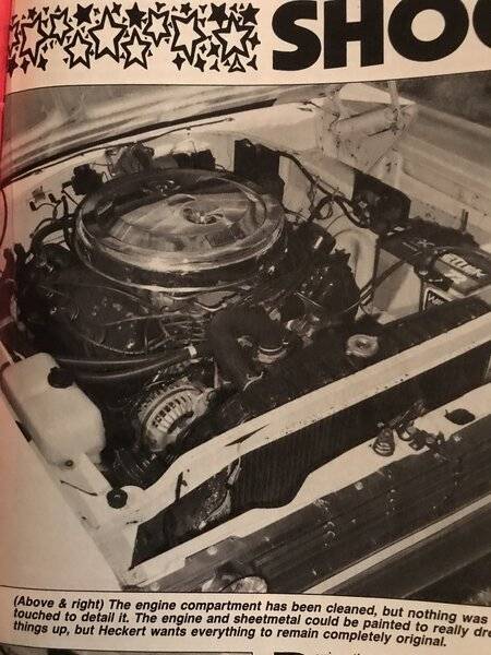

Here are a couple of magazine article pictures of very low mileage originals - I believe one had 11,700 miles and the other 9700 miles at the time of publication. Not great pictures though and don’t tell much.

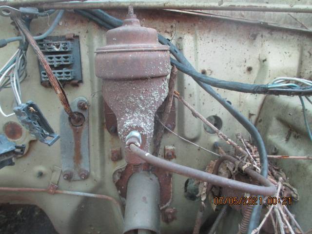

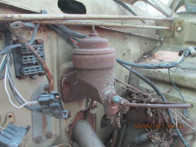

1966 B bodies with disc brakes DID have a single pot master cylinder . BUT,,, they have an added section to the top like Fran mentioned.
Still uses a bolt down lid.
The dual reservoir arrived in 1967 models , regardless of all drums or optional disc brakes
You can just make out the added ring on this listing . This is a 6000 mile unrestored car

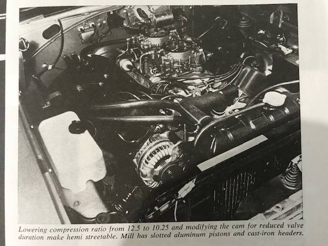

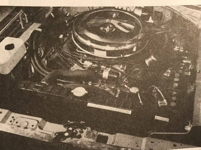

Had a back injection today so had some time to rummage through my library some more. Found this Satellite Hemi test in late 65 which show equipment like the 66 Coronet I posted a while back - 22” radiator and same radiator hose - neither of which made regular production.
View attachment 1219595 )View attachment 1219597

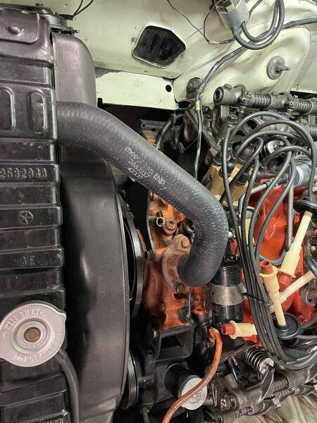

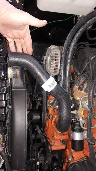

Nope, I'm still here. I did buy this hose (as seen on page 1) just for the heck of it...
....but it kinked when I put it on so for now just I'll stick with my 1969 383 (with 26" radiator) hose.
This one kinked Richard - it looks pretty good in the picture. It clears the fuel line with a little room to spare like you would think Ma Mopar intended. Maybe the kink is on the underside.

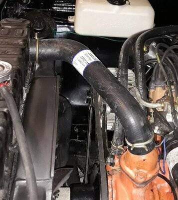

I am working on the car today.
And tried the continental 60621.
And its to long with no way to shorten it and keep the shape.
So im back to the drawing board
