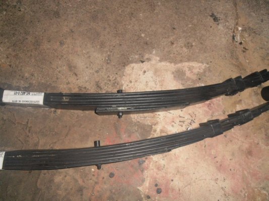

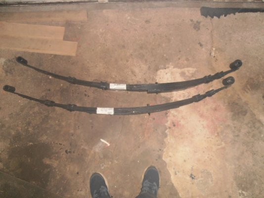

Hi all
Well my old stock springs are shot, it looks like my ex-wife and her sister are in the trunk----bad.
It's an original 318 car, now with a mild fresh built 383-auto trans.
So I bought the springs in the photos, from https://www.generalspringkc.com/ . They are their Hemi/440 springs 6 and 7 leafs.
What I need to know is the bolt length.
Thanks

7" to 8" , your axle tube is 3"
8s you will prob end up cutting little off when done.
Make sure the inside of the tube concave is flat were it rides on the tube.
Some of the cheaper ones are round and makes it easy to dent the tube.
Don't go nuts with the impact it's pretty easy to dent the tube.
Mancini has the proper U bolts that will not dent your axle tube.
The old 7", give or take, O/Length that came off the car will work just fine. Factory 6/7 leaf U bolts are 7 7/8" O/L and there's over an inch of wasted thread sticking out of them.
Thanks dadsbee, I'll try the old ones first. If they're too short, Mancini's only about an hr from me, and my brother works up there quite a bit. They do have walk in service.

Quick Update;
The old u-bolts worked out just fine!!!!
I ran a 1/2x20 die up the exposed threads, just to knock off old rust and ka ka-----------perfect.
