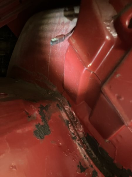

C pillar lights not working. Then I saw these disconnected leads in the trunk running toward the c pillar area and wonder if that’s what they are for? If not, what are they for?
What wiring is needed to complete in either event.
Probably the C-pillar lights. They plug into the trunk harness on the driver side and run under the package tray.
Package Tray, the area between the back seat top edge and the rear glass.
I'll look for more. Connector at upper right of pic.
That’s the place. Drivers side trunk harness. One wire splits off from the rear light harness there and runs across underneath the window and connects to a wire lead running out from the passenger side rear wheel well (I assume that then runs up to the passenger c-pillar light?)
If that’s where that passenger side wiring goes, then I’m looking for a similar lead out from the drivers c-pillar I guess that goes to the open connector in the picture?
Anyone know if I have that correct, and then where to look for the wire leading down from the drivers c-pillar?

I found the other connector! Since the passengers side wire came down from the c-pillar and out into the trunk over top of the passenger wheel well, I looked closer at the drivers side wheel well and voila there it was hiding down in the there.
HOWEVER, now I’m having other electrical issues with parking lights, running lights, and brake lights all not working, but I believe are unrelated to connecting up the c- pillar wiring.
Embarrassed to say but yesterday I tried tidying up some stray wires and prob broke something. Have to trace that down now. ….ugggggh
