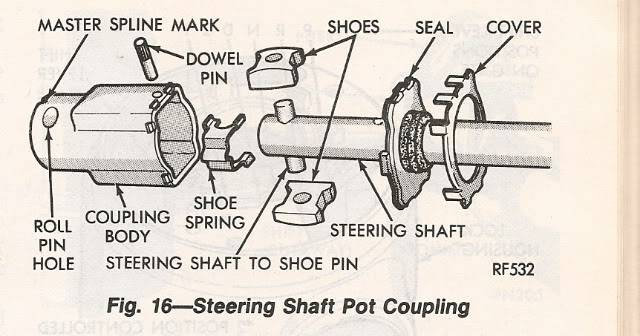

But my concern is the column it's my understanding the column is different lengths.
So just looking for options and opinions
Is there a good conversion kit? A good steering box?
Old days (30 years ago) they sold an adapter to lengthen the PS column to reach a manual box. The splines size is different PS vs manual.

If you do decide to go manual steering, I have a 66 manual steering shaft and a 66 manual coupler that I would be willing to sell. I just finished converting my 66 to PS. Personally, I would stick with the PS.
