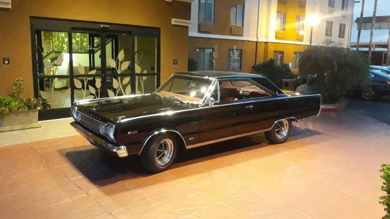

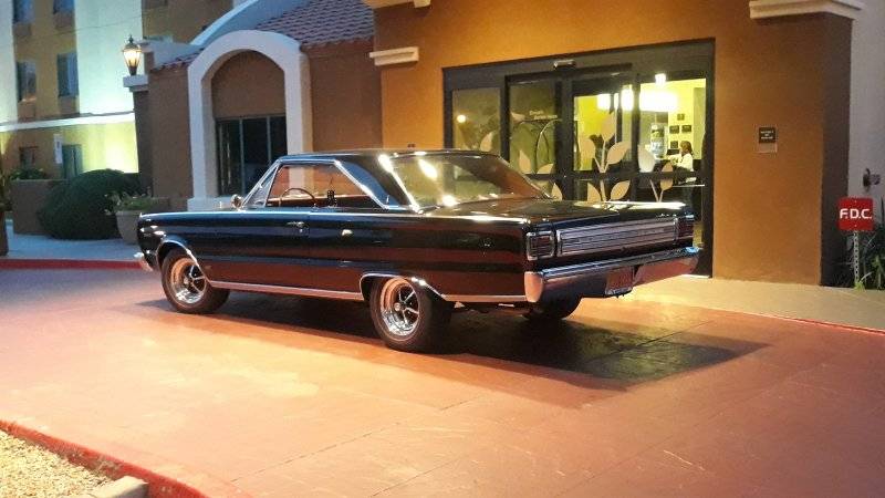

I have 15x7s and 245-60-15s all the way around and I have NO , NADDA, NONE, ZERO issues on either end
I can get you any picture at any angle you want this weekend

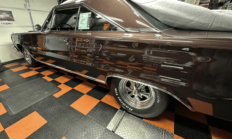

I bet you have power steering. :) The 235/75 on my 66 Hemi. with manual steering, give me a heck of a workout getting in and out of my side loading garage. I’m think smaller when I re-tire it.
Yep. Power steering was added when it was restored . Thankfully
Im good with same size tire on the front, but when the time comes I may upgrade to a 255-60-15 on the rear next time
I went conservative with 245/60/15 on the back with 15x7's and 4.25" BS. Probably could have fit 255's but.....
