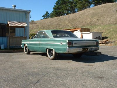

I have that tire on my 66 Bel on factory 15x7 Cordoba wheels and they fit perfectly. Here it is with sagging original rear springs.
