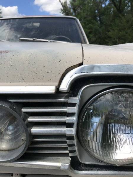

I think the corners of the hoods are different. Single headlight versus double headlight.
I have been corrected on this. Hood corners are the same.

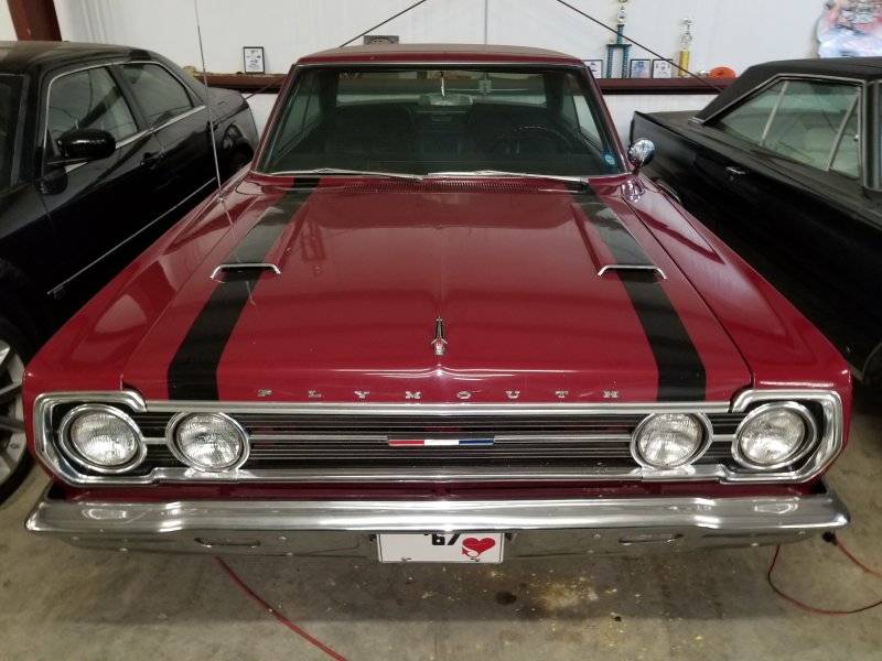

Moldings are different for sure, 67 hood molding is wider. And my picture angles aren't exactly the same... And I'm too old to be swapping hoods by myself anymore... So the debate continues....
I have to disagree, I have both 66's and 67's
The inboard headlights have nothing to do with the hood, and the parking lights on the 66 are also contained in the grill. The 66 and 67 fenders are different.
I'm not at my building now but my friend that helps me out, just made a measurement for me. The inside measurement and outside measurements on the front of 66 and 67 hoods are exactly the same. I didn't ask what they were, but just if they were the same.

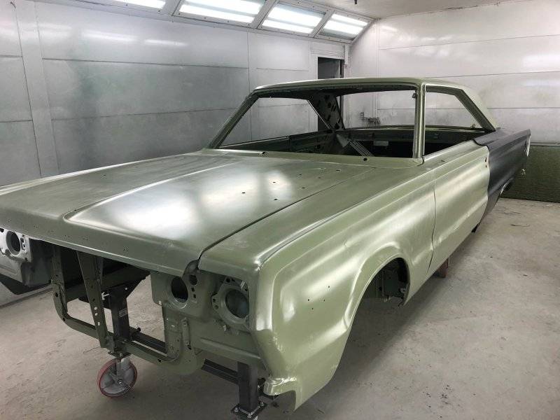

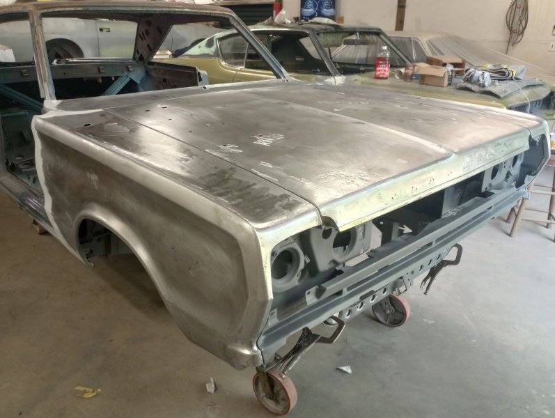

Here's where we're at currently...I'll post more pics as the work progresses

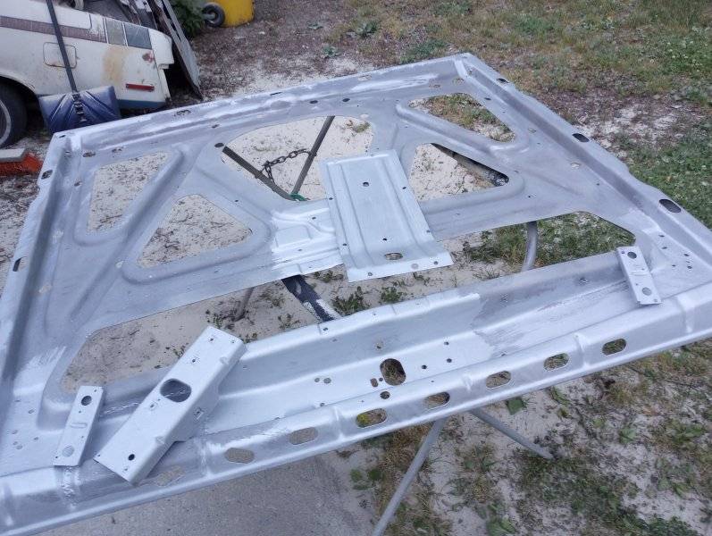

Thank You! My body guy said it'd probably be cheaper for me to find another hood than repair mine cuz it's tweaked from an accident years ago and doesn't sit flush with the fenders. I guess it comes apart pretty easily once the spot welds are drilled out?
if I remember correctly, there were 32 welds...... took me about an hour and a half to get them apart

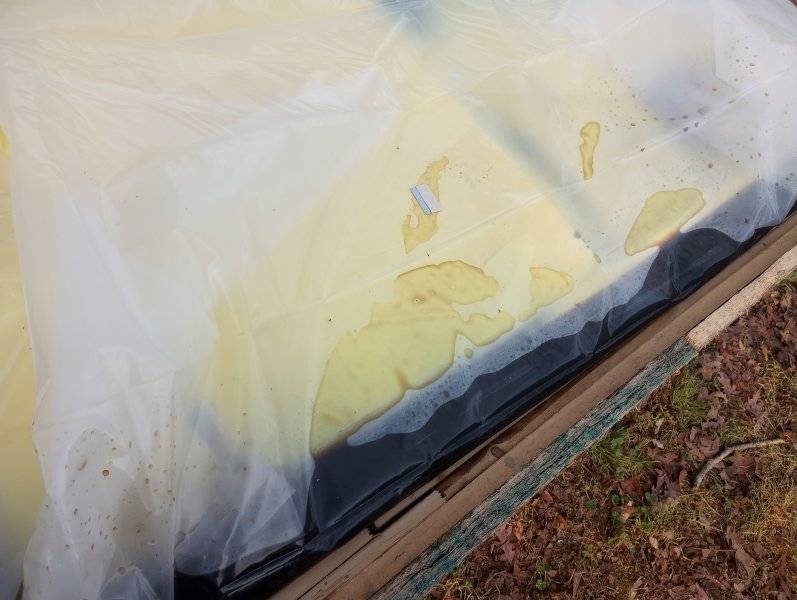

I sandblasted the frame, and put the skin in a molasses bath for about a month; phosphoric acid and elbo grease would also work
