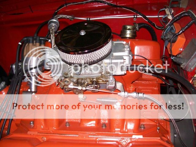

On my 63 Plymouth Sport fury I use a Lokar cable and the stock pedal assembly and it works great for me. I just bought the Lokar cable and carb mounting bracket for the cable and put it on. You cut the cable to the lenth you need and it has been on my 63 since 2006 and still working like new. It was simple to install and I have no complaints at all with it. I use a 440 R/B block and the Indy dual plane intake with a Holley 850 DP. Ron
I believe this is a better pic of the cable at the carb. This is an older pic when I had the old valve covers on the eng and no heat shield under the carb. Ron
