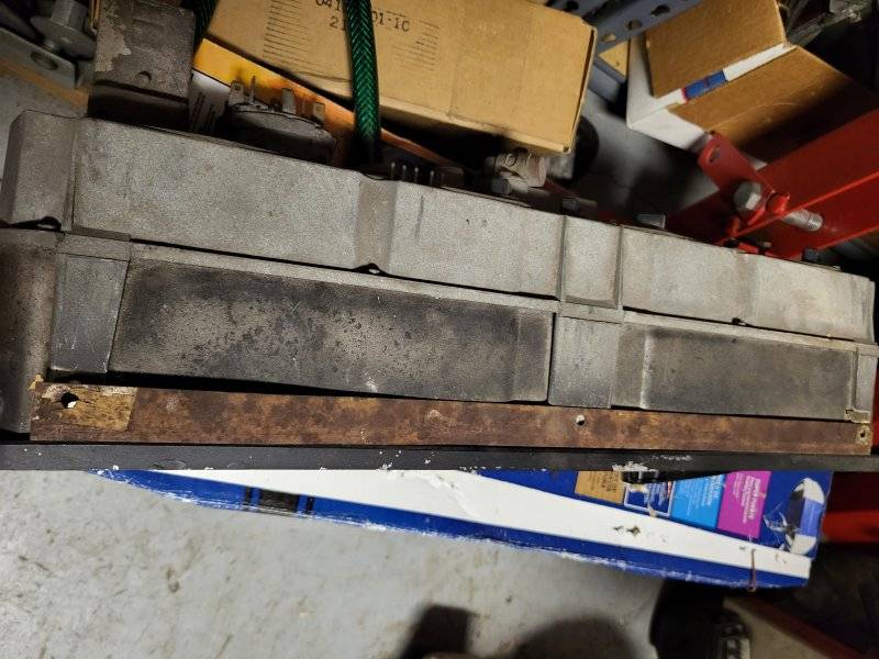

I have had three '67 Belvederes. All of them had issues with the instrument panel ground. The dash lights would flicker out; then flicker back on when I tapped on the dash above the instrument cluster. Make sure that the metal ground strip on the top of the instrument panel and the metal dash itself are clean and you have a good solid ground. Doing so fixed my issue all three times.
The cluster gets grounded to the dash frame through the metal strip that runs along the top and is secured with the upper bezel screws.
Was just looking at it. Metal strip on top of the cluster has some corrosion. Gonna clean it up and test. Hope it works! Thanks!

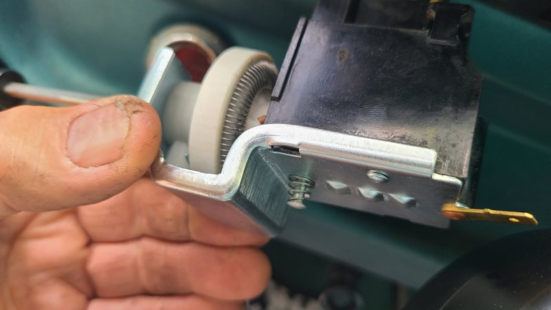

Well, I got a new headlight switch and installed it. Got the left side dash lights back, and the new switch has a ground tab on it. Maybe they figured out they have grounding issues? So, why did only half the lights come back?
