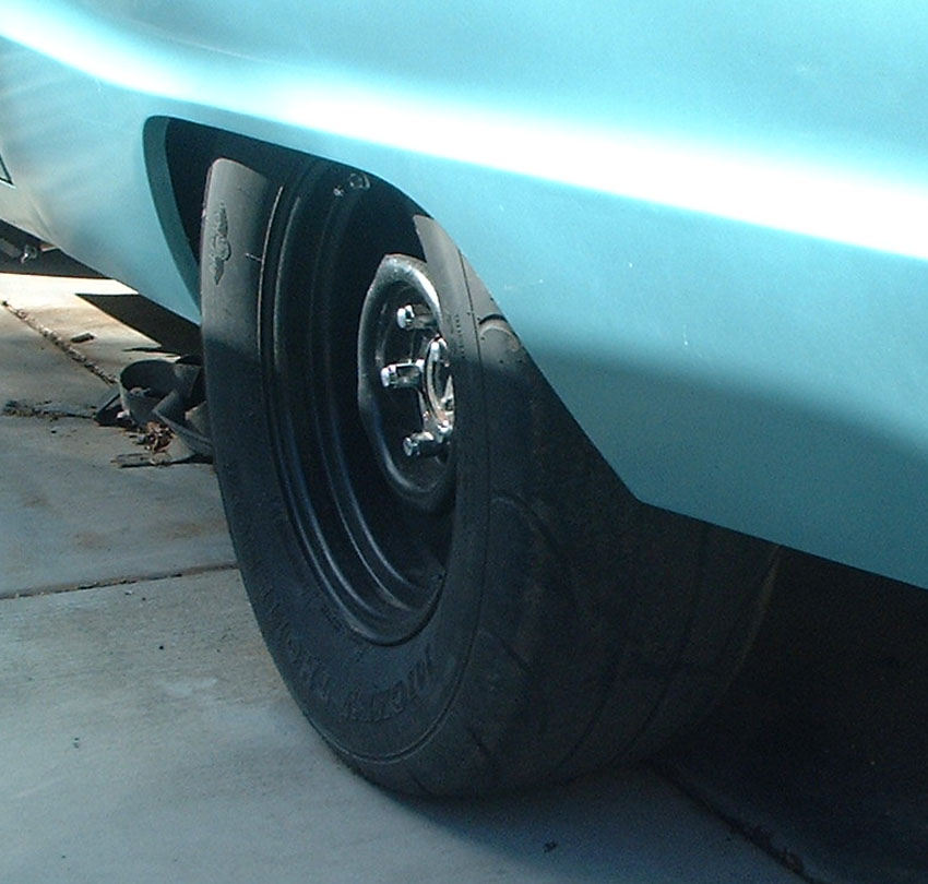

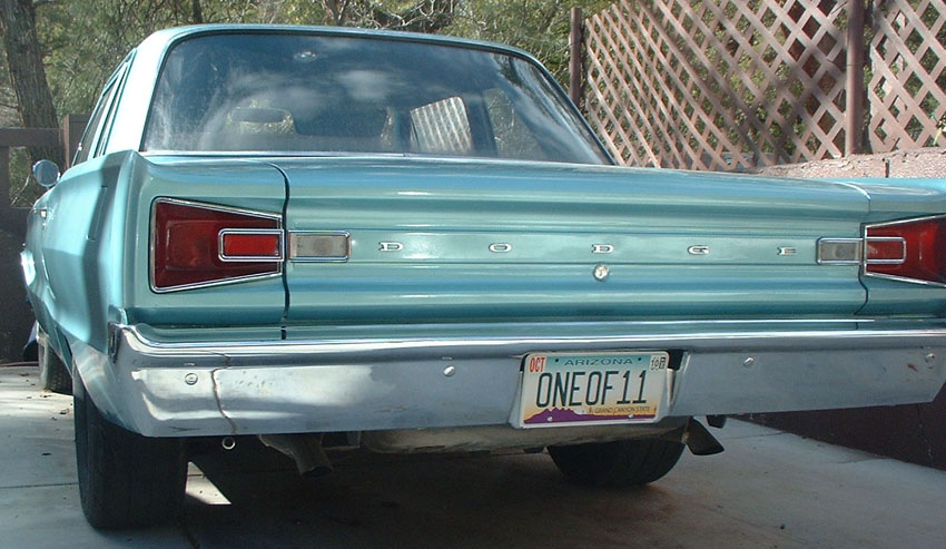

That is what I have on my 66 Hemi car as well.
