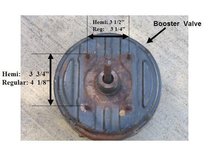

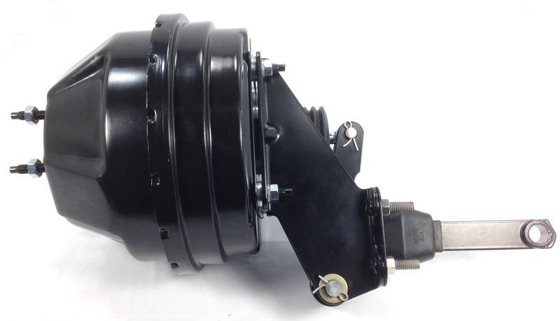

He is probably going to send you this. It was the reproduced set up. It is on the original B body Non hemi booster rear stud pattern, vice the Hemi stud pattern (pic attached). Hemi studs are also larger at 3/8" vice 5/16". Also, I do not think your booster is a donor for a Dual diaphragm bendix rebuild. Yours looks like a single diaphragm, but not sure it is a bendix either. If you get what is pictured you should be fine for your needs. That stupid GM version or a later model A body would look out of place even on a driver in my opinion. But folks do it.
The booster I posted#20 how do you tell single or dual diaphragm? If that's a dual diaphragm Dean I'd grab to have it if finances allow.

Thanks for the detailed measurements and explanation. Now I understand completely the rarity of this booster. I'll give it some thought, thanks.
Dean, the problem with internet websites is that a guy like you comes along that does not know what he has or needs and some well meaning people try to help. The problems is, some of them don’t have a clue as well. I know hemi brakeboosters and brackets very well. It will do no good to give you the complete tutorial on them because you will not find an original one, more than likely. Sufice to say, the correct hemi booster with the special dropped end,like in my picture, is not reproduced. It is very hard to find. The original brackets only fit the original booster. Dr diff sells a reproduction dual diaphragm Bendix booster that fits ALL cars. He sells a reproduction hemi-like bracket that fits that reproduction booster and it will work. The repop stuff will not exchange with the original stuff. Don’t buy from the ram man as it will be a nightmare to get anything from him. Ask anyone. It won’t be correct either. Just buy the entire booster and bracket from dr diff and be happy he makes a reproduction part. It will be close enough that only a guy like me can tell.

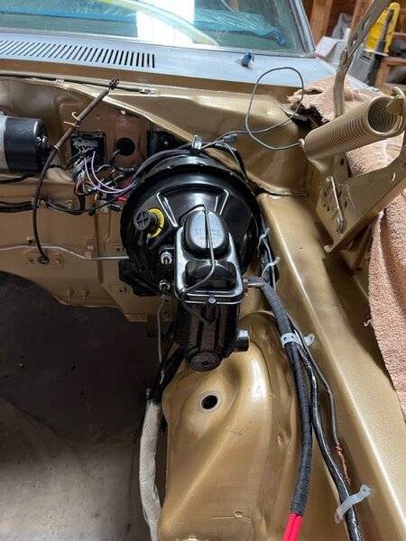

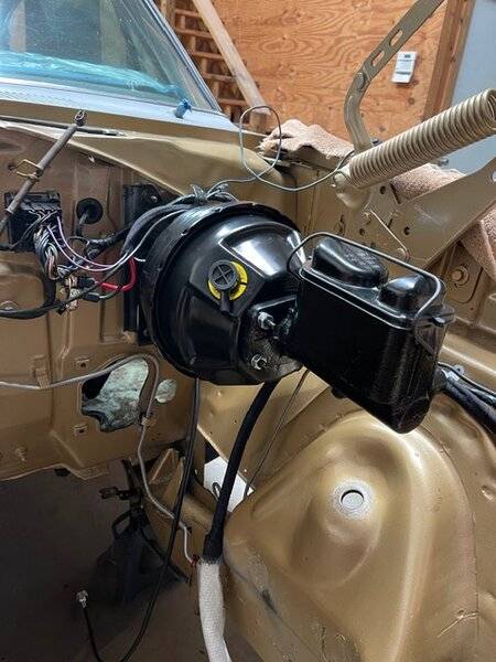

Fastmark, I installed the booster and master cylinder I bought from Dr Diff for my 67 Hemi with Bendix 4 piston calipers. Very happy with the outcome. See attached photos.
Well. I hate to “brake” the new to you but that is not a hemi booster. We need more pictures but he may have sold you an a body unit. It has a offset bracket. I just bought a real hemi booster and bracket for a 68 hemi car. It was $1500. You don’t want to know what I sold my 70 ebody booster assembly for.
