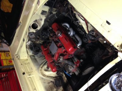

67 coronet 500 5.7 carbed hemi project
A little more action....taking my time obviously.

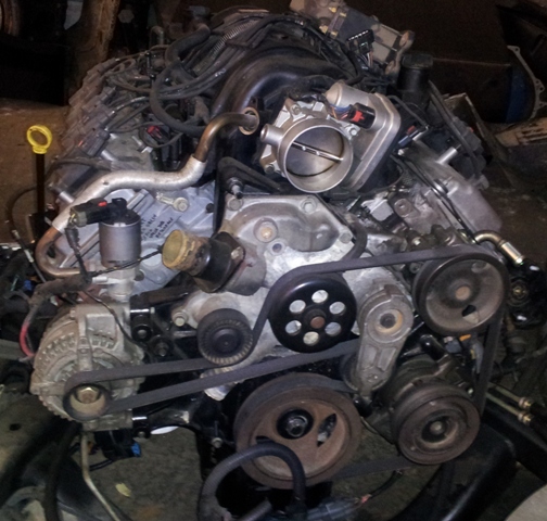

Just pointing this out......the belt needs to wrap around the water pump pulley a lot more than what you have in the pic!
do you have a pic for reference? this is how I bought it and how previous owner was running it. Will it help once power steering is added? I haven't touched the belt system from where it was pulled out of his vehicle when sold....
thanks for the heads up but I need to see what it needs to look like...??? and I WILL be adding power steering...
If he isn't running a mechanical fan that will probably be enough to run the pump. If he wants to run a fan, then yes I agree with you. If he runs it that way with no overheating issues and no squeal or excessive belt wear then it should be ok. I would just monitor that going forward for a while.
I will be running the fan that came with motor... and I will also have power steering on it which will change it all together.
Example
Here is the serpentine belt from my 5.7L hemi . . . this came out of a Dodge Magnum station wagon . . .
The car setup is different than the truck set up . . . but this is an example . . .
You see how much belt is wrapped around ALL the pulley's? That is needed to prevent belt slippage. So when you add power steering, your arrangement will change, but try to get as much belt around the pulley's as you can.

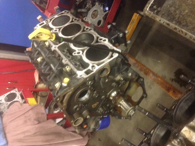

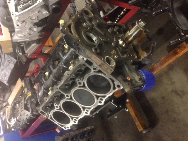

small update....
engine tore down, cam and springs going in this week
new milodon oil pan going on with new pick up tube...this week
new 6.1 coil packs on the way, going under indy intake...
trans is being built and dyno'd this week... orig 904 beefed up a smidge
need to start ordering parts and get off my butt and clean and paint under hood...spring be here before I know it.
engine hopefully be dyno'd within a couple of weeks...once cam and springs and carb are in and built.
Except for the water pump pulley, driven by the back of the belt, which has very little coverage... My 6.4 is very similar - not much wrap on that pulley, but it seems to work!

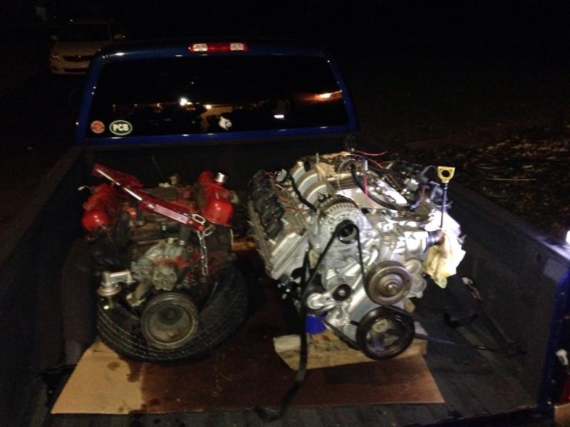

ahhh....here is the little fella....poor thing.
